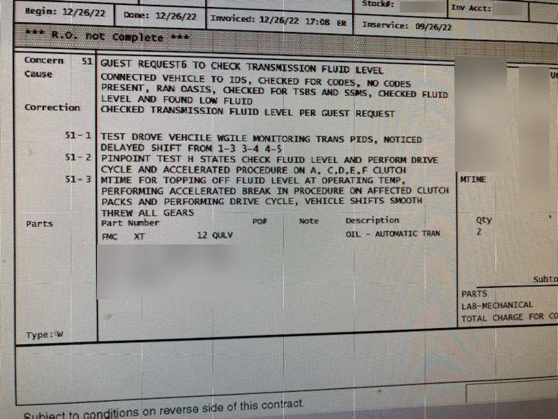

For what it's worth, here's a description of the transmission service. Their test drive definitely highlighted the issues I had. Looks like I was 2 quarts (!) low on fluid, which seems like a lot.
Looks like they didn't reset anything but did test it after. I'm really looking forward to driving it home.

So, just picked up the car and drove it home, about a 20 miles trip with a mix of freeway and side streets. It's raining, though, so I couldn't go crazy with it.
So, the transmission tech said he did an "accelerated break-in" process, which I think means that it reset the transmission tables. He said it would take a little while to work everything out and might still be harsh for a bit. But once it settles in and particularly learns my driving patterns, all should be good.
Interestingly, normal mode shifting is already smooth as silk. Night and day difference from before, and I'm certain it's not just placebo. Where it would shift harshly 1-2/3, 3-4, and especially 4-5, it's now entirely smooth. Almost like driving a new car.
In Sports mode at low throttle, it's still a bit rough at times. The only "bucking" shift I noticed, though, was 3-4 a few times, and I'm hoping that's just the learning process and it will balance out. Things were better at higher throttle, although again, it was raining so I took it pretty easy.
I think it's safe to say that if you have any problems with your transmission, the very first thing to do is get the fluid level checked. And the extra care the technician gave to the car was very appreciated.
