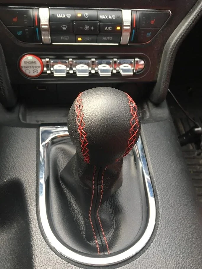

More details on that shaft and ball please.
I'm trying to do the same thing and have a manual redline boot & ball coming in.
Mr. G
Ira
Apr 25, 2016
143
new york city
Ira
2016 ecoboost premium convertible oxford white

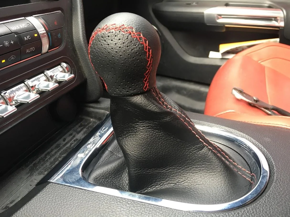

i got the shaft and ball from sickspeed.com. they didn't have the shaft for the mustang on their website so I emailed them and they created an ebay item which I purchased. the screw on top of the shaft is 12x 1.25 so not sure if you have to drill out the knob you purchased. It is a push down to shift and works fine. here's a link to one of their ebay items, not sure if it's the right one but contact them and they'll take care of it.
http://www.ebay.com/itm/BLACK-ADAPT...ash=item566a2116db:g:3t0AAOSwawpXqRCZ&vxp=mtr
JohnDoe
<3 short walks to my car
Mar 23, 2015
89
2,135
1,109
stop and go city traffic
15 pp vert

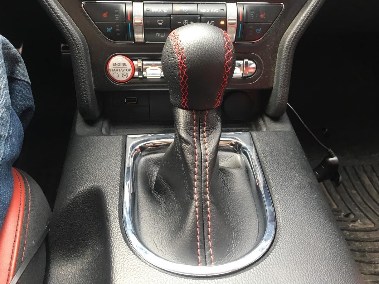

Wow, I am pleasantly surprised at how well this matches my redline interior
I love how much lower the shifter is now. Feels like I have so much more room. Just have to get rid of the habit of resting my hand on it since it shifts by pushing the knob downwards.

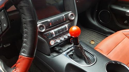

Can someone with a White Madness knob measure how high it is? I want to compare some things. I know it's shorter than the auto.
