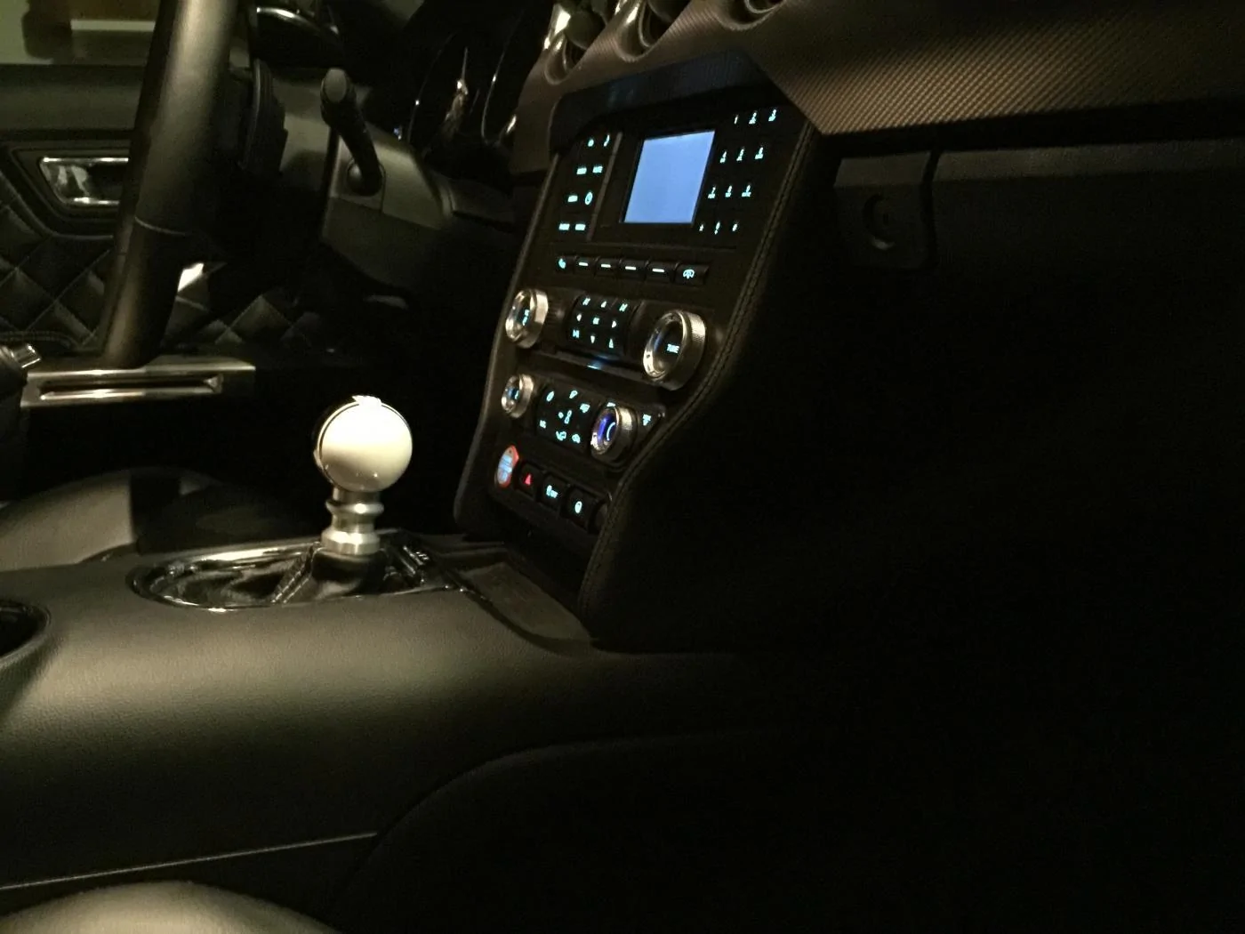

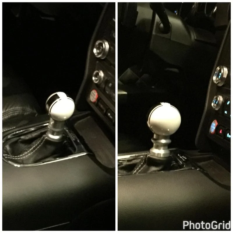

I bought a shifter on eBay to test fit it first and I was going to have different one built on a cnc based on the concept of the sickspeed one. The sickspeed piece is thin aluminum and has a slider inside that is very thin aluminum. To me it's cheap quality but the concept is pretty good. There is a sleeve that a threaded pin sticks out. I noticed that when the pin is screwed in tightly it can cause the sleeve to pull outward and make the outer shifter part to rub and get tight. When I remade mine I made the inner sleeve out of stainless and much thicker and the outer shifter part I made much more to look like the factory one would look. You can see in my picture. I put a spring inside mine and it sits perfectly on top of the inner sleeve and works exactly the way it should.

The shifter on left is original that I made and the other is revised and shorter.
