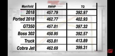

Yes the VMP shootout showed ported vs non ported. Typically it has a small peak increase and limits the fall off slope but it doesn't change peak power rpm.

Porting it gives you better average HP and torque. Look at the the dyno graphs from the VMP shoot out. The ported manifold HP/TQ curves look way better throughout the RPM range. Just Don't look at the peak numbers.

My reply was to that question. It's unlikely you'd be able to measure the difference between ported intakes.
Also way better is a bit of an overstatement, though the point is made.

Our intakes are ported by hand by our 2 full time porters in house here in Arcadia, FL in our warehouse next to our new shop. We have been porting the 18s since February of this year and have had great success with it and have several hundred out there being enjoyed by our customers currently. All of our intakes make amazing power and pull to 8k strongly. VMP did an awesome test showing the differences in the intakes.
We prefer to tune the cars with the lockouts installed as we sometimes see issues with the 18 IMRC running on the 15-17 cars and we 100% always delete them for boosted applications.
We tend to push ours a little deeper while still ensuring a quality port job that is smooth and polished for maximum flow. Each intake takes roughly a day to be ported and polished in a 4 step process and packaged up correctly.
We have sold hundreds and I can count on 1 hand the number of broken intakes we have seen. (Pretty sure the guy dropped it in his garage) But we still got him a new set of IMRC (thats all that broke) right away!
If you have any questions just feel free to holler at us on Facebook, on here, or at [email protected]
We have a Christmas deal going right now, and we offer the intakes with MMR Lockouts, or Pigtails.
Pricing starts at $500 shipped.
https://automafiaracing.com/product...d-unported-w-lock-outs?variant=12620015730711
these are VMP's results. We have some new ones coming once our new dyno is setup this spring.
