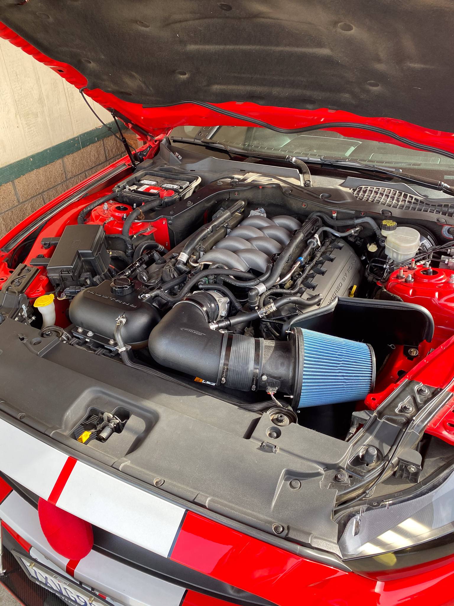

I currently have a 15-17 PMAS Cai on my 2016 GT/CS, will be having a 2018 ported manifold installed, will I need to swap to a 2018+ pmas or JLT cai or can I use the 15-17 version. My main question is will it fit correctly? Would like to figure it out before shelling out more $ if I don't have to.

Hey this is Junior from N4SM, I was able to use my 15-17 pmas intake when i swapped to the 18 manifold. You won't need the 18+ intakes. Side note my tuner had me lockout the IMRC's on the 18 manifold when I put it on my 16 GT. Not sure if it will be the same for you.

Also how did you get around the angling of the 2018 manifold I know some people said they couldn't shut the hood because the way it angled up the 15-17 pmas

Glad I could help, and to be honest there's not much you can do. You can adjust the rubber hood stoppers to lift the hood up a tiny bit when it closes but you just have to slam it shut. The intake will touch the hood a little bit but I didn't have any issues with that.

It will fit correctly. The only thing I tell our customers is the way the TB is angled on the Gen 3; more of an upward position. But, judging by the photos above, it should be fine!
