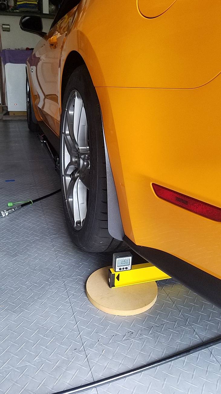

I put down two flat and smooth (3/4" thick MDF) boards to establish a reference surface next to the tires.
I laid a 6-foot level ($14 at Harbor Freight) onto the boards.

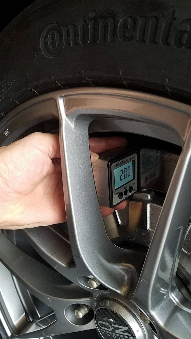

I put a small square magnetic angle gauge ($12 off eBay) on top of the level and near one end. I zero the gauge. Then I hold the gauge against the rotor to read the camber.
I repeat for the other side. With this technique, the gauge reads zero at the other end of the level without having to re-zero the gauge. This is a measurement validity check.

I had a lot of trouble getting consistent and repeatable measurements when I set the gauge down in the 90° position, zeroing the gauge, and then magnetically clipping the gauge to the rotor. Too bad.

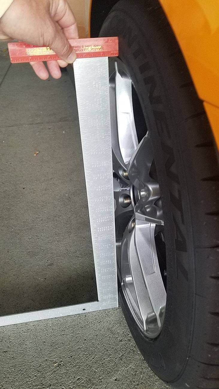

In theory, if you DID have a perfectly flat floor, you could use the simple method pictured here, and do the math. Camber = Tan-1[Offset / (contact point spacing)]. In this example the tire is offset from the framing square by 9/16", and the lower contact point is 1.5" above the floor. So, Camber = Tan-1[0.56" /(24 - 1.5)] = 1.4°.
I actually drove around to a couple parking garages in search of a flat floor, and this technique was not too bad.

IMPORTANT NOTE
I had the same problem (but noticed it was consistent with zero set with the gauge right side up). I gave up, set zero with the gauge right side up, then used simple math addition/subtraction from 90 degrees when I attached to the rotor; i.e., 87.4 degrees equaled -1.6 degrees (87.4-90.0).
