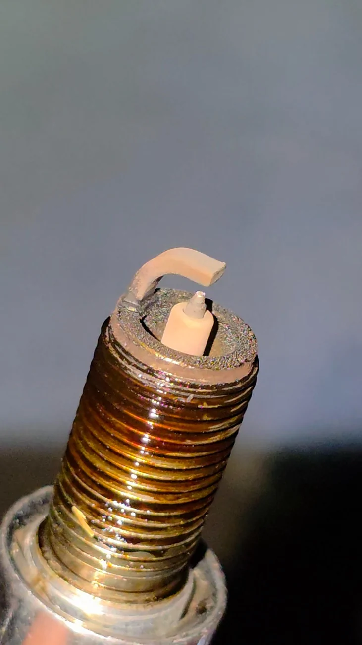

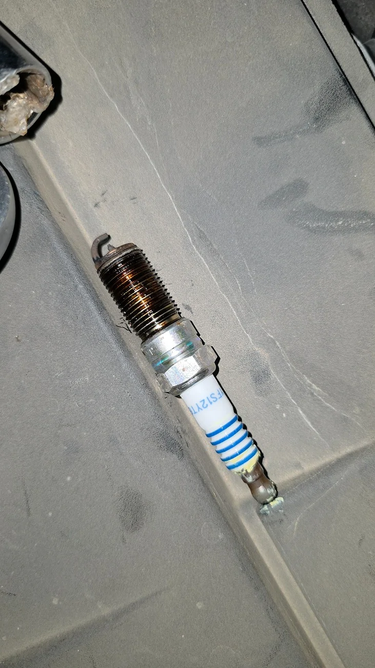

Hi, I have a 2023 mustang GT N/A , gutted headers, and backfire tune.
pulled one of my factory spark plugs out at 17k miles, And it looked like this.
My car is pinging especially when giving it some gas at higher gears,
I tested "Spark knock" and it retards timing as much as 4.8 degrees.
I suspected the plugs and one of them looked like this.
I have been using the same fuel and it started pinging just recently, tried different gas stations and it's the same.
The backfire tune was on the car when i bought it and it is really aggressive, Can it cause such issue?
And shouls i swap my spark plugs to new ones? or re-gap them?
what gap should i go for if i do so?
Thanks alot for any help 🙏🏻

They look fine. Measure the gap and if they're in spec put them back in.

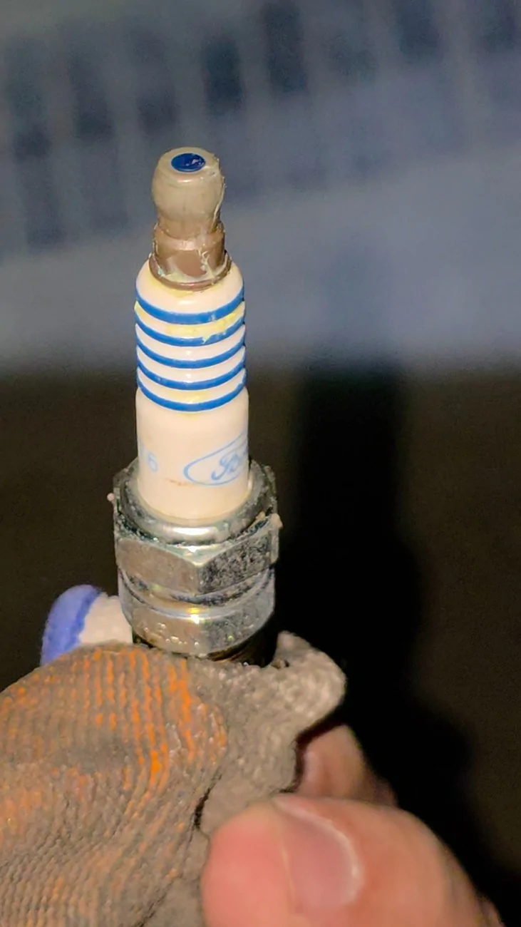

Can you provide a picture of the plug that can actually convey some information?
Sorry, How should i take the pictures to convey more information?

With respect to the photo, the ground, electrode and insulator cone are most interesting. If you can capture a photo from that end of the plug, that'd be great.

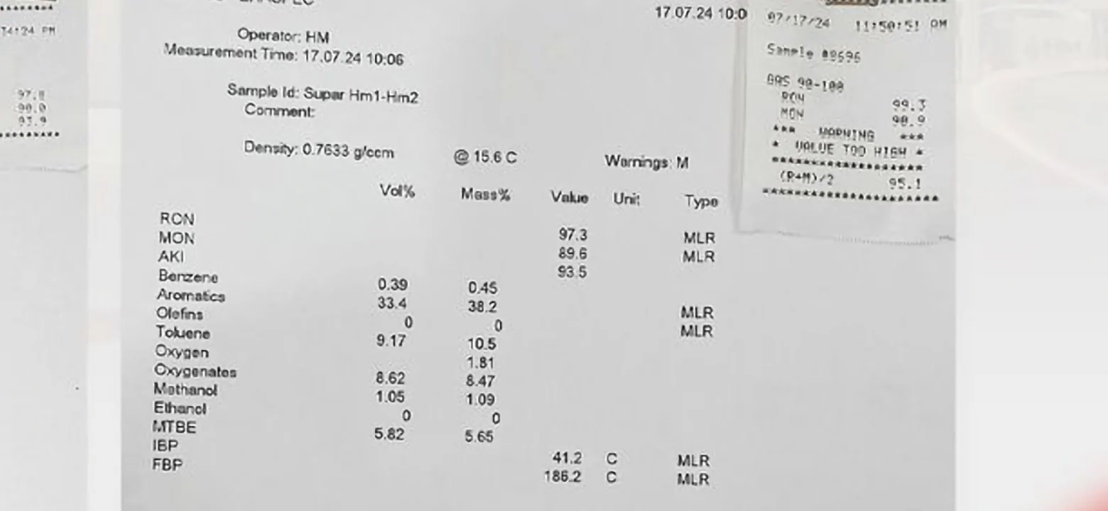

*This is the full test of the fuel im using.

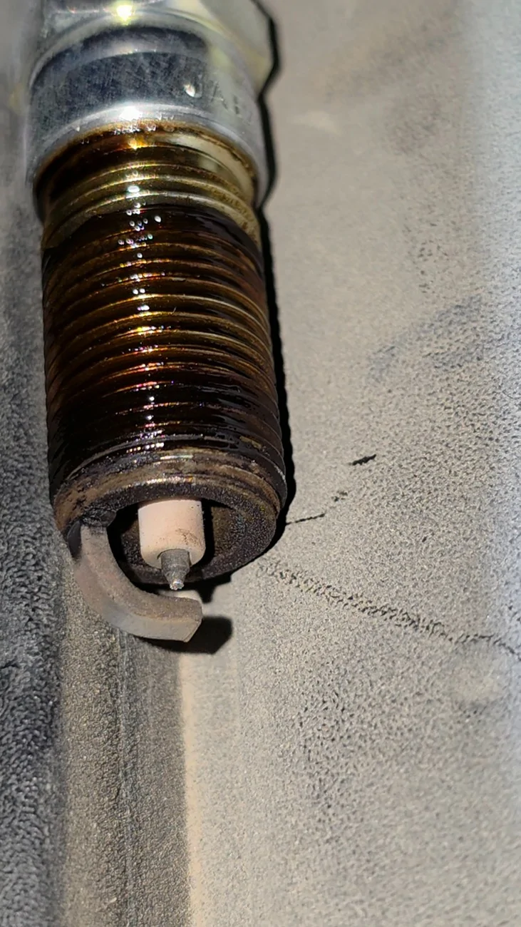

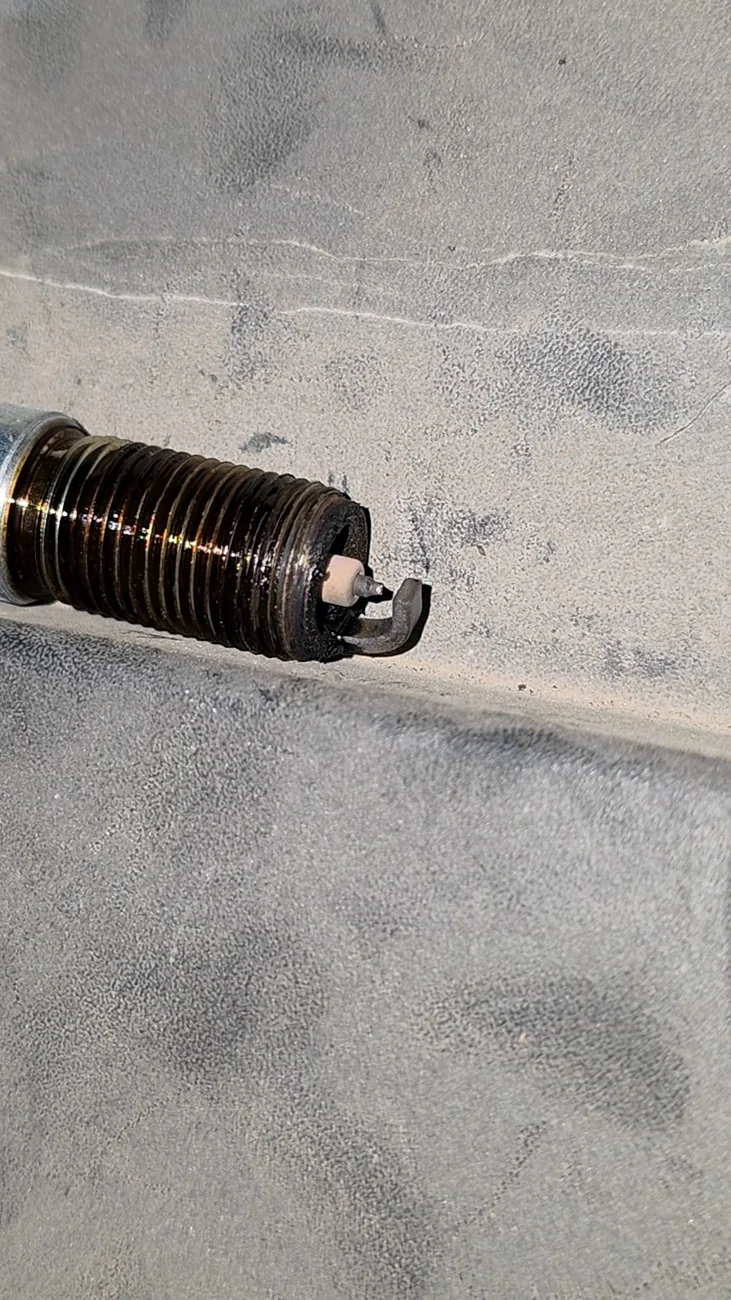

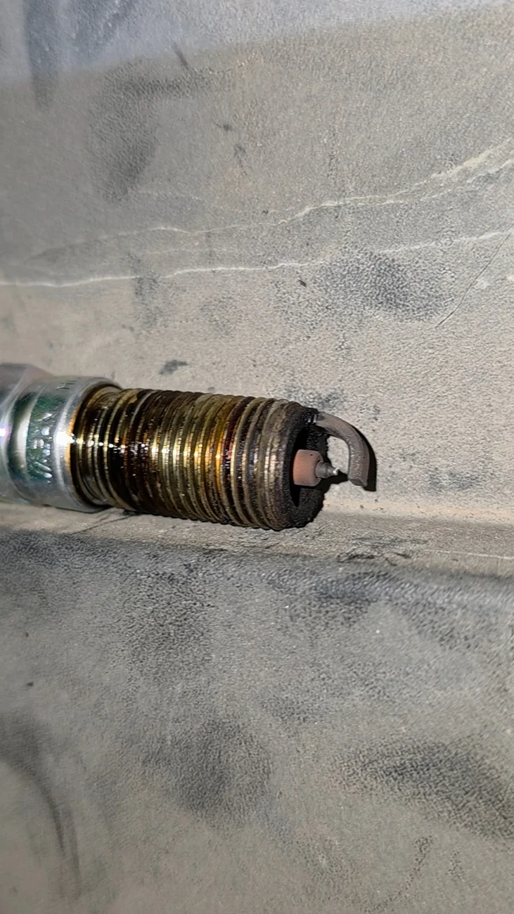

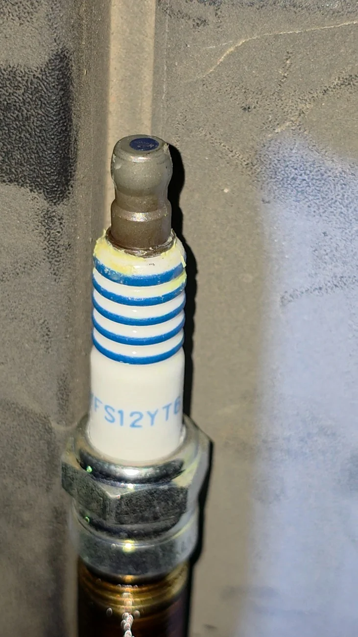

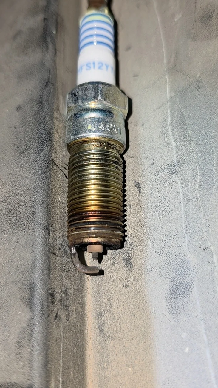

Here are as many plugs i could pull out:
*It's been less than 3,000 miles since my last oil change, It was at the max level on the dipstick, Now it sits at between the min and max holes of the dipstick.

The RON/octane level seems fine. The US equivalent is 93. Good.

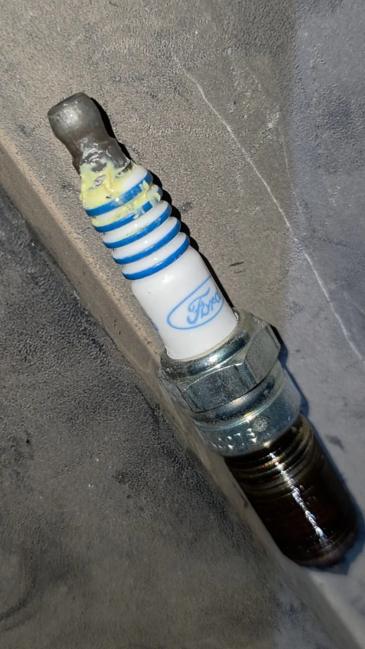

You're burning some oil, but we don't know how much. You should track that. See how many miles/kms it is before you have to add one quart/liter. Burning a little oil in normal driving is OK. But I'm afraid the oil being burned is contributing to the pinging. All the spark plug threads have oil on them. The plug threads should be dry.
For regular vehicles in normal driving conditions, Ford considers burning more than one quart in 3000 mi/4800 km to be excessive and needs to be investigated.
For performance vehicles, Ford considers burning more than one quart in 500 mi / 800 km excessive.
The electrode ends of the plugs look OK. That's good. There are some deposits in some areas. I attribute this to the oil and excess fuel being burnt.
Those are Ford plugs. Since you're making the effort, I'd buy one new set of plugs for that engine. Gap them to the recommended gap. Plain, stock spark plugs recommended for that engine. Buy from a reputable business or web site, so you know you're getting the real thing. Counterfeits happen.
