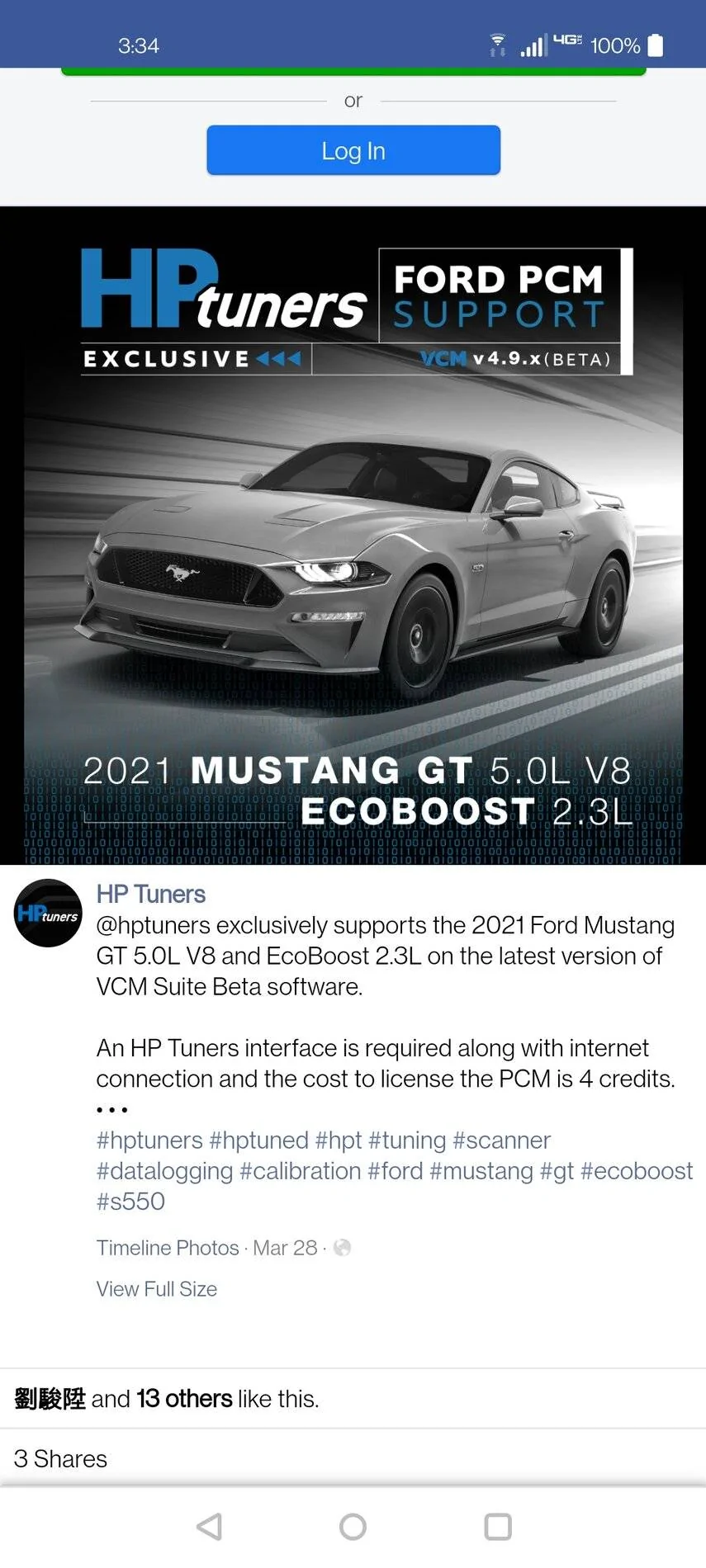

The 2021 mustangs are listed as tunable by HP tuners.

Since the end of March.

ok so I’m assuming Lund and PBD should be able to tune them as well then

PBD uses the RTD and Ngauge so if Lund can tune them so can PBD or any tuning company that uses HpTuners software.

I just checked, Lund tunes the 21 GT with HP Tuners. See here.

SCT released support in late February or early March
