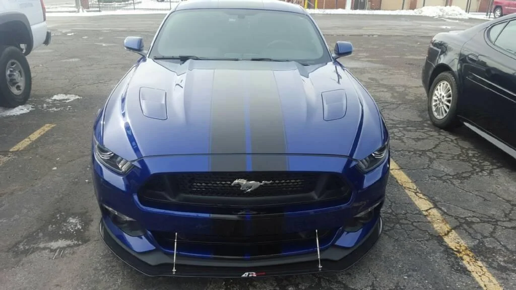

Just had the best body shop(as far as I am concerned) in Indy do the splitter while he was putting on the stripes.
I love it.I was so pleasantly surprised when he charged me ONLY $300 for everything- stripes and splitter install.
Super nice guy too.He does all the decal and body shop for all the local race teams.
Any one looking (like I did for a long time ) for one stop shop for this in Indy send me a PM.
I am going to be dropping off my magnetic car for the same(if I can get the splitter early next week) when I pick it up.
I was going to wait on the GT 350 or Steeda front fascia because they sit lower to cover some of the turbo pipes that hang low on that car that are visible from the front but so impressed with this,I am just going to the splitter and call it a day-save my self some $$$ for go fast mods!
