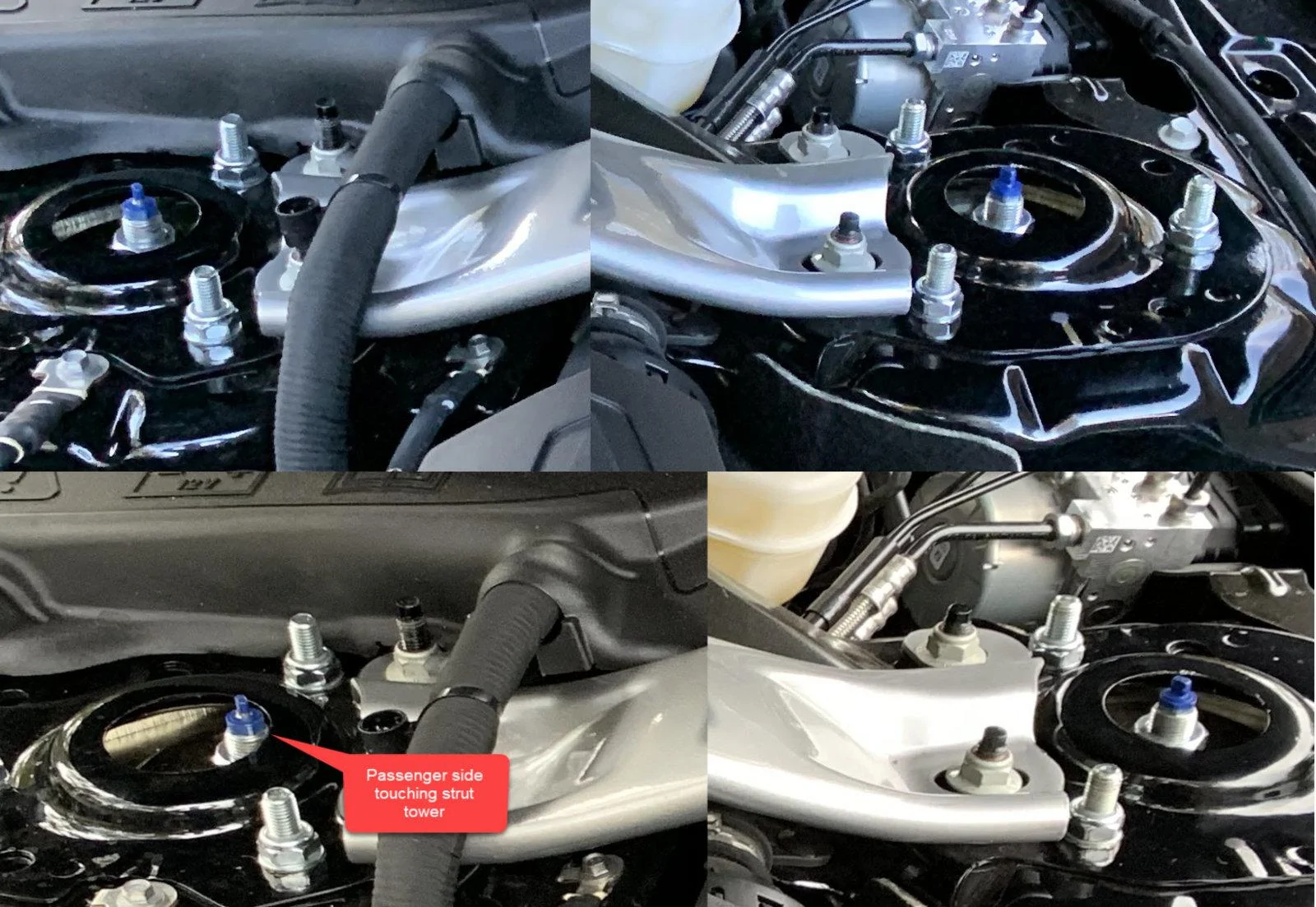

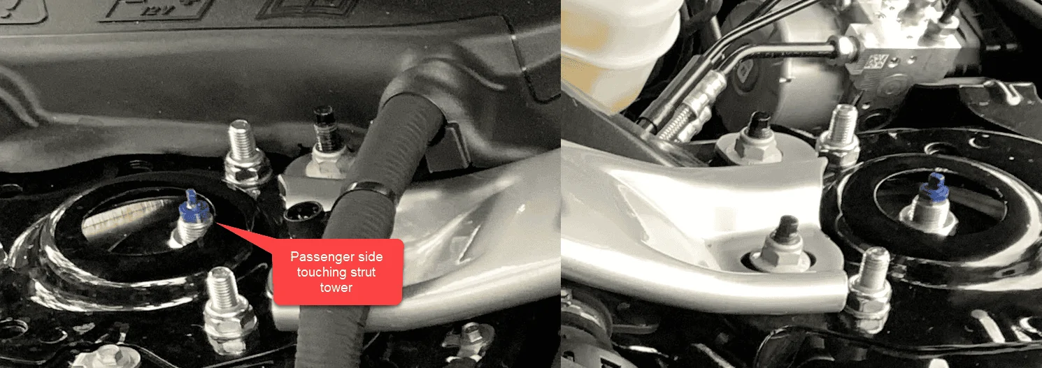

I had the local Ford dealer install a set of Steeda adjustable pro struts with adjustable camber plates. When I went to adjust the struts for the first time this afternoon I noticed the passenger side touching the side of the strut tower, about 3/4" difference from the driver side. I did have them align the car with the specs below.
Is this anything to be concerned about? Would there be any reason for the difference and is that side maxed out in any fashion?

With that large of a difference I'd have the alignment rechecked.

I'm thinking that the K-member is off . . . by about half the difference seen in the strut to beg hole clearances.

It's certainly possible that the front K-member is not centered and off some, but not that much. It would be worth checking, though, along with another recheck of alignment.

So I went back to Ford and they could not find any issues. I spoke with Steeda and they could not provide any answers. Ford rechecked the alignment and a bunch of other stuff and everything was according to spec. They messed with the strut a bit and pushed the -2.5 within 1/2 degree and now the 2 sides are closer to matching.
Doesn't make sense to me but the numbers add up and it looks closer to symmetrical.
The top is after the changes today and the bottom is after the initial alignment Friday
That looks fine now. What's the alignment sheet look like? When you say pushed within half a degree, how far was it out?

They did not print out a new sheet (I should have forced the point) and said that it was within spec in every dimension when they checked it out. I was told that they loosened the strut and tightened it down as soon as it hit -2.5. I was told it was just barely within the spec, whatever that means, after the change. I trust the guys but have a friend that has been doing alignments for 25 years and may have him check it out. It feels okay and handles like a dream. It just seems like something was off.

That's a large difference between the "before" and "after" photos. Maybe the alignment folks didn't tighten things up afterwards, and the plates slid against the strut housing. Either way, glad it is all good now. It looks great!
