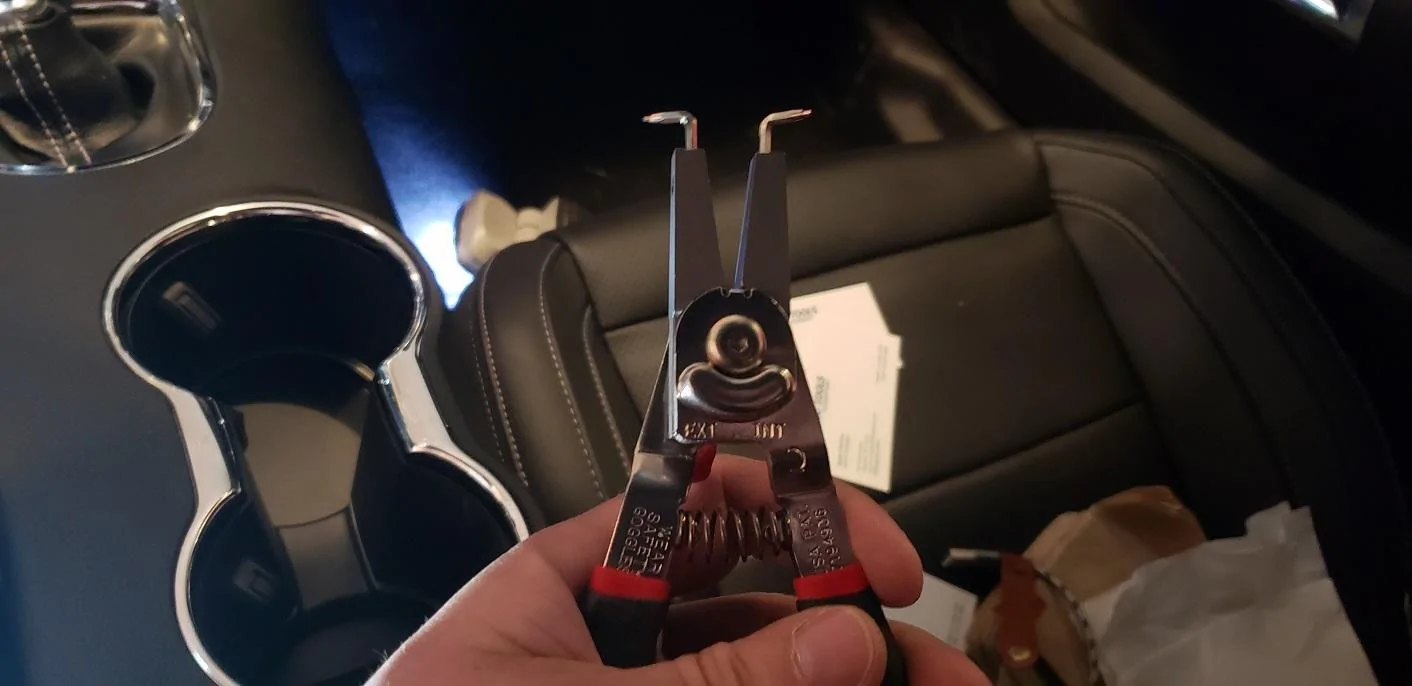

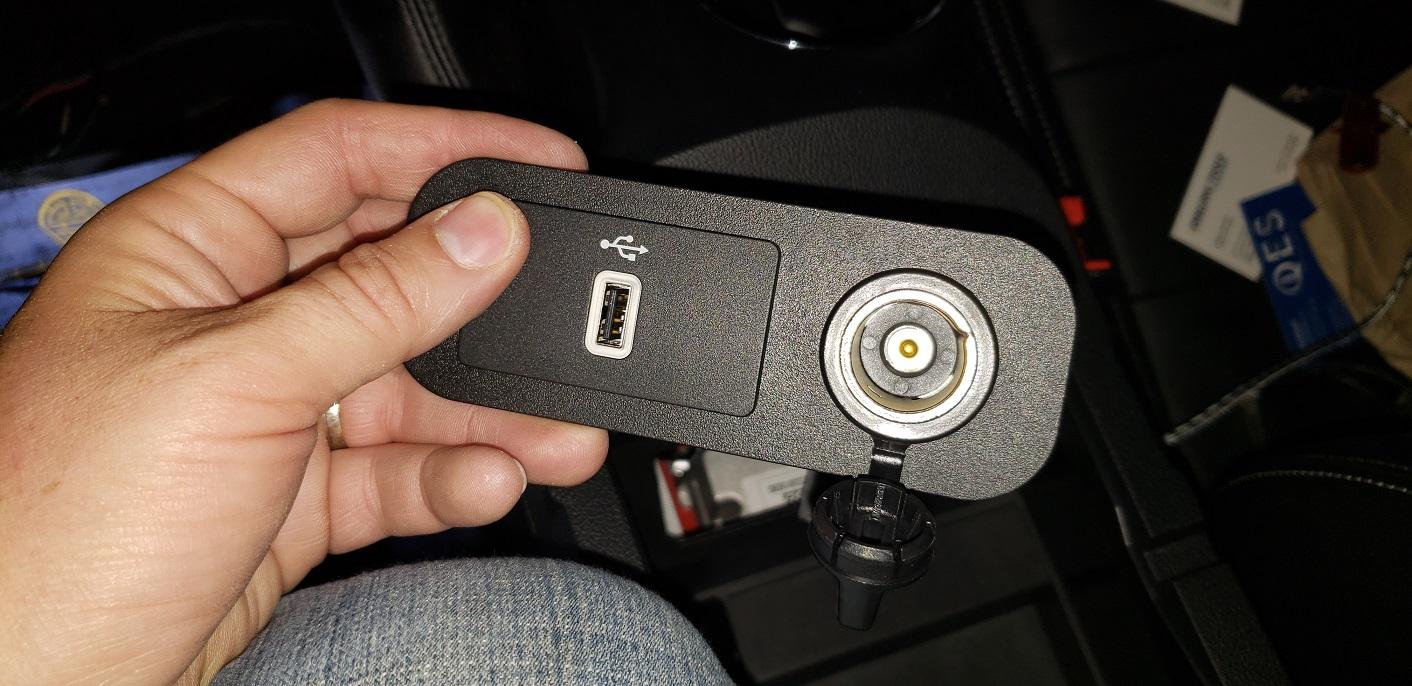

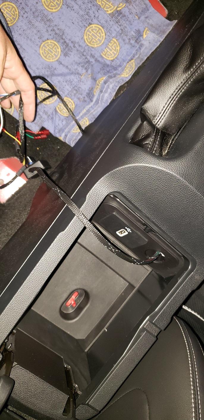

I got the Auto Blip installed today. I removed the cigarette outlet from the console and routed the wire through there and down the side of the console. I didn't get a picture of it but the controller is stuck to the inside of the console on the right side facing the driver. I used channel lock snap ring pliers to spread the plastic tabs inside of the power outlet so I could slide it out. Working with the wires under the dash wasn't fun but I got it done. Just used the provided wire taps and checked everything for continuity after installation. Got it calibrated and things seem to be good. The weather is trash today but hope to test it out tomorrow. Track day is Wednesday.
