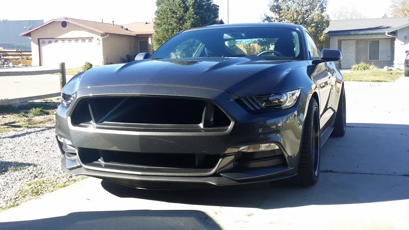

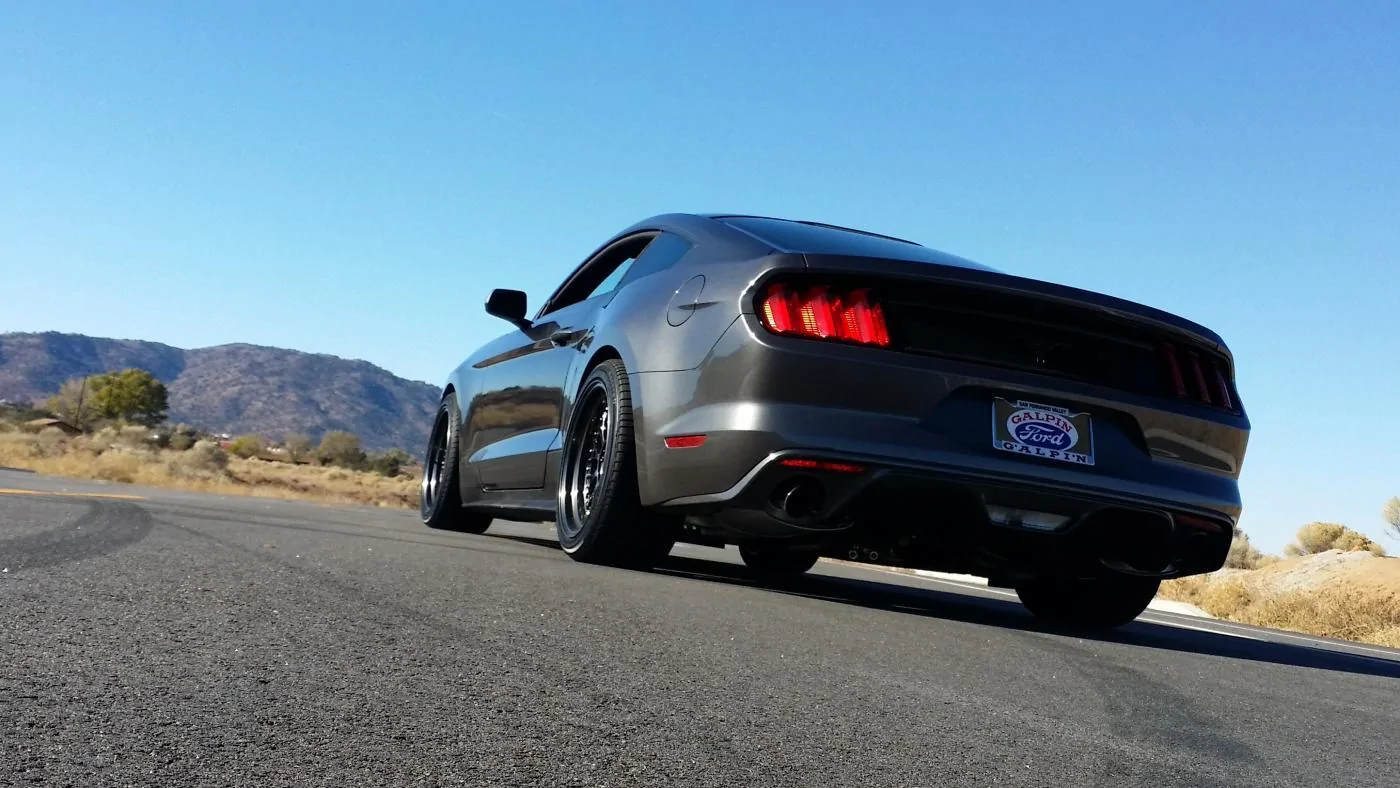

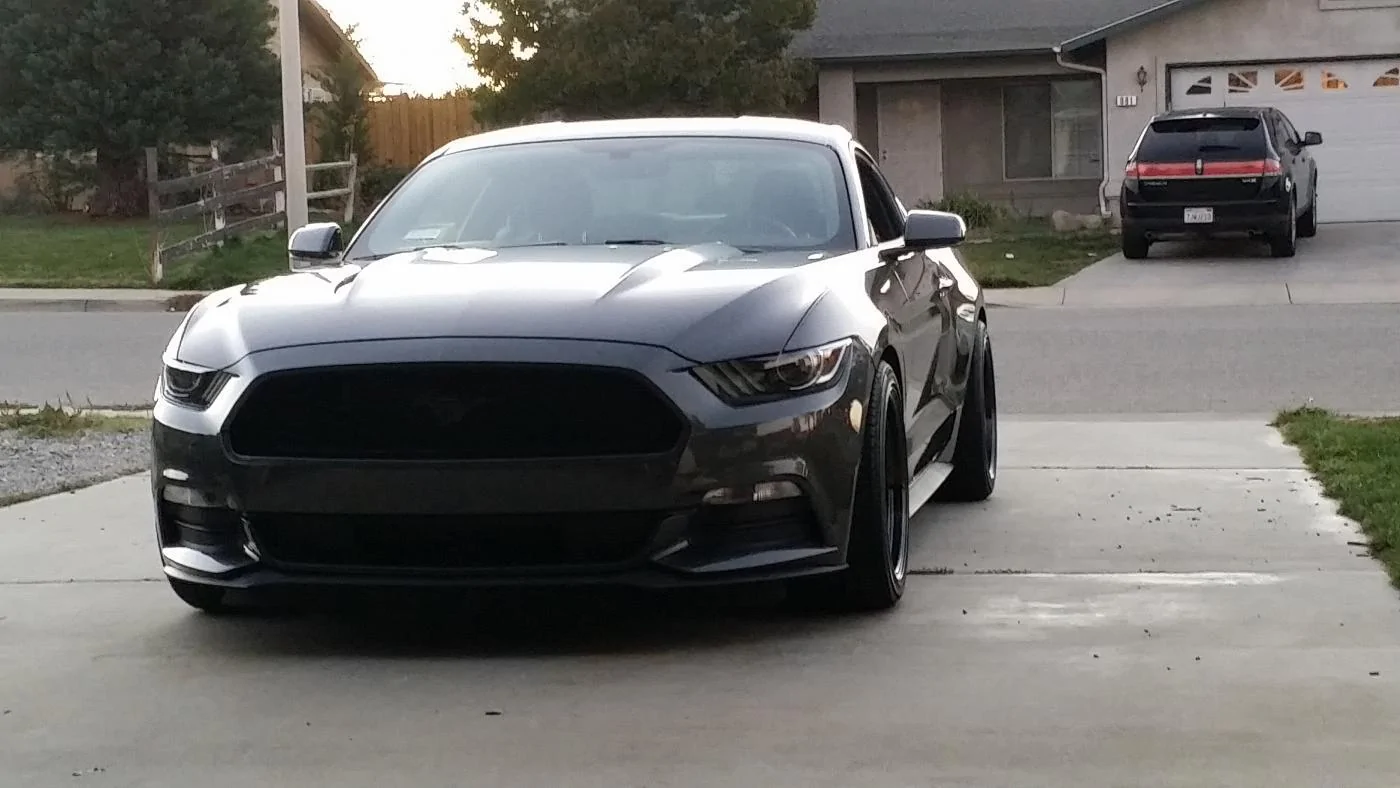

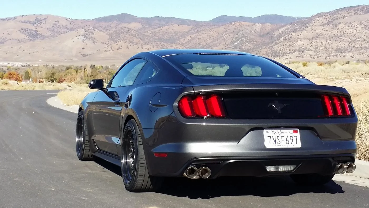

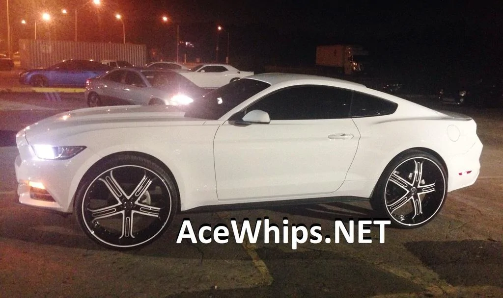

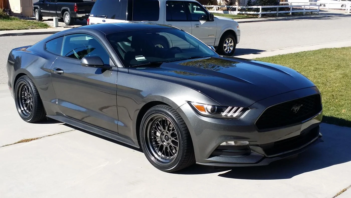

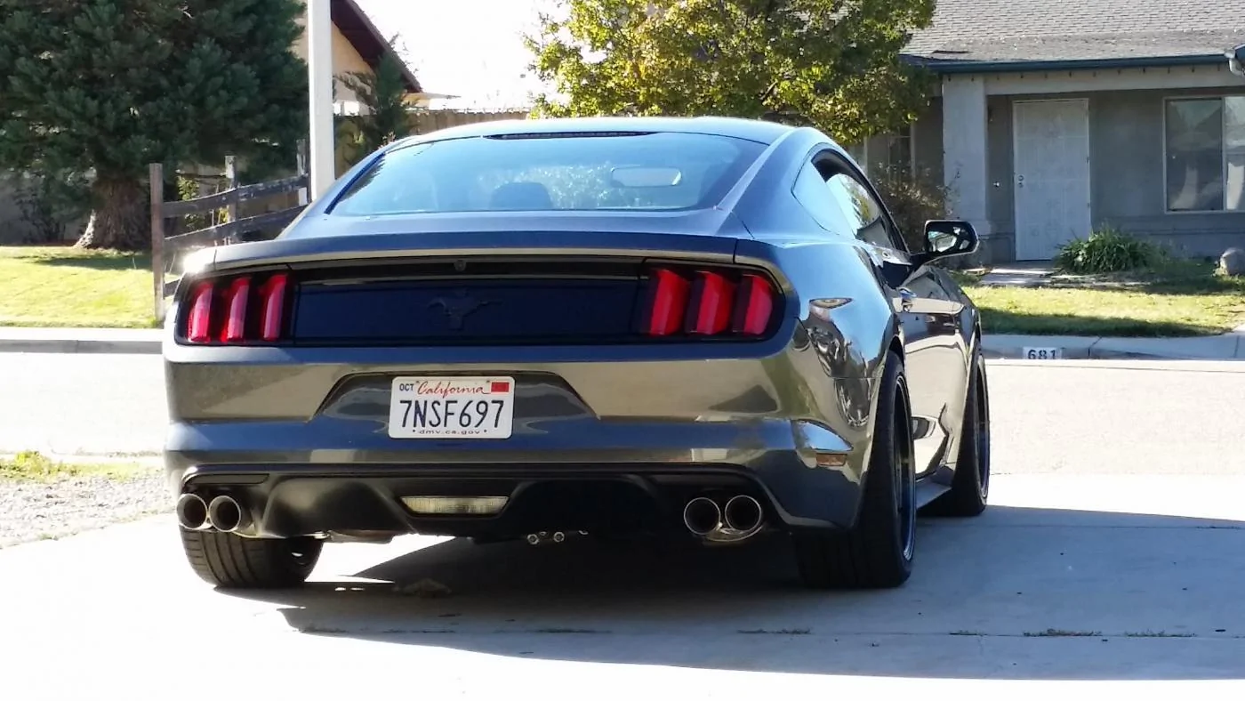

here is mine with 285 35 18s which are about 26" tall. my car is on pro kits. these wheels and tires only weigh 50lbs together(per wheel) if you like the look of 20s on these cars, your not going to like it. im a little old school...I think 20s are kinda huge for a "performance" car, but they look ok. I prefer a little less wheel myself. I love how my car looks. would probably look a little better on sportlines, but hey, its my daily and I comuute in it...I don't spend all day driving to car shows :p I wanted it to be drivable...and not have to work about scraping everywhere
