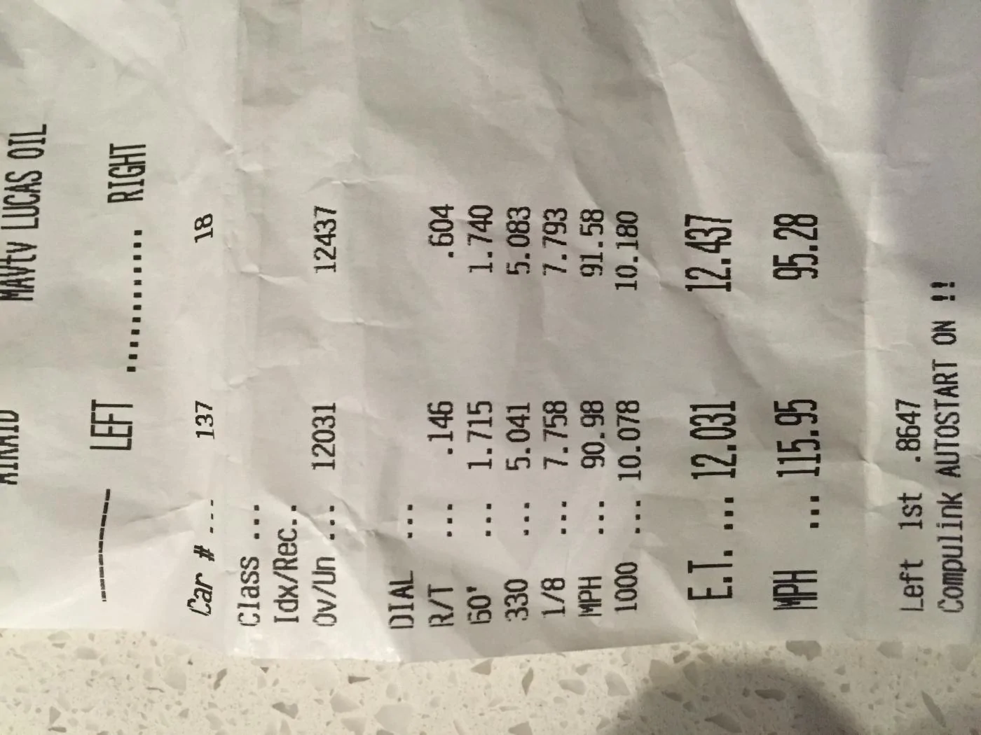

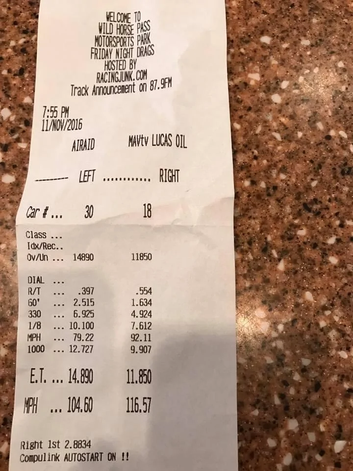

Stock intake, hpipe, 3.31 car, stock TB, GT-350 manifold. Car runs strong. My bud has a PP car, JLT intake, headers, no cats and the gt350 manifold GT-350 t.b. He trapped .5mph faster same night.

Is that on E85, seems really quick for stock intake !!! :eek:

Yup E85, density altitude was over 2000ft, 12psi Hoosiers. The 12.03 is me btw, car needs shocks and springs ... The base GT suspension can't handle the launch. Finishing the 1/4 mile in 3rd gear lol

None the less still impressive. Get a GT 350 CAI and TB on there, might get you into 11s.
Lund tuned or custom?

Lund FF. More is to be gained with shocks and springs then with an intake. Will do headers before a "cai". Better driving or better air would have put me sub 12s, but no excuses.
