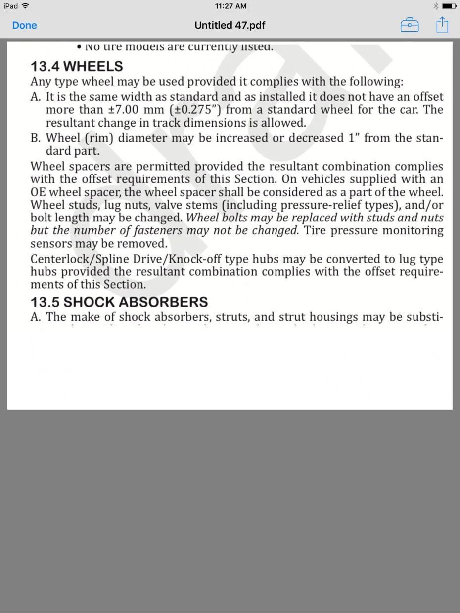

Didn't change rim widths because running SCCA AS class. They do allow up to 7mm change in offset so took advantage of that. Tire will be 305/30 around.

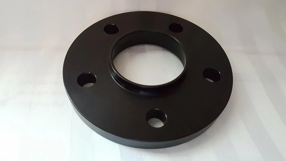

Like these? A member here is running them fine with a few track days under the belt on this GT350 with a 19x11+50 square setup

I would not hesitate to run a spacer as long as I have adequate thread engagement. Just walk thru the pits at a track event. They are everywhere and I have never seen a problem in over 10 years of running them.

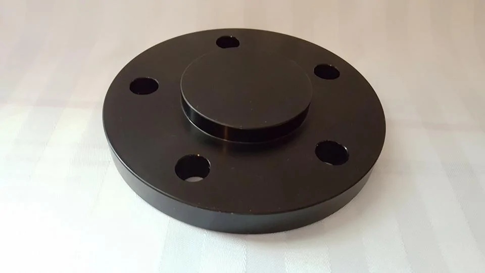

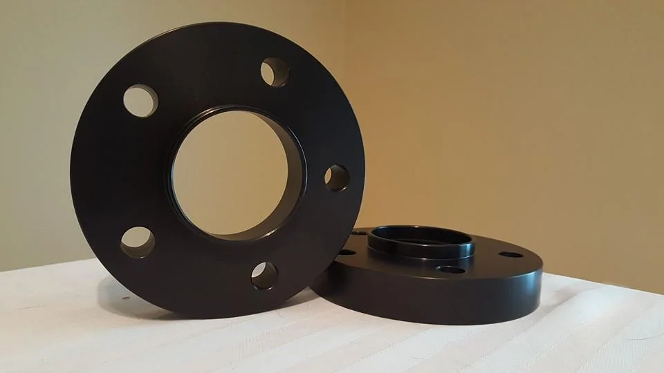

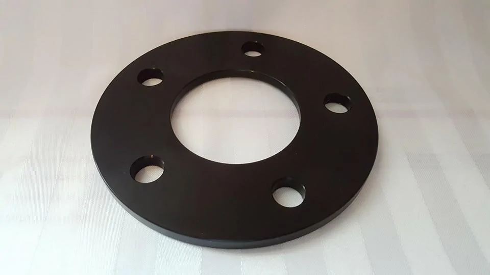

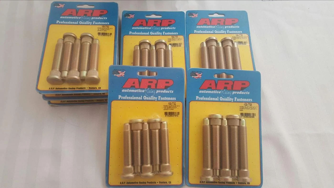

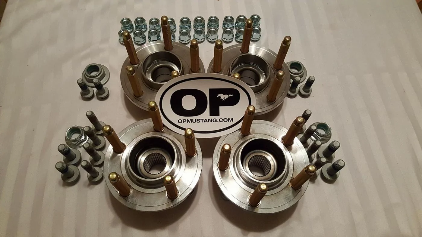

There appears to be some mis-information for some of the members who posted on this thread.
1. Extended studs with hub (and wheel if over 12mm) concentric spacers are completely safe and you will find spacers on pretty much every professional road racing car in the pits.
2. The Shelby only shares the rear hubs with the S550 Mustang. The Front hubs if you order the "R" hub for the front it will have extended length studs but they are only production car strength. Shelby Specific Extended Hub kits are not available for the Shelby (front) from Ford Racing.
3. We offer spacers HERE and ARP 14mm Extended Studs (have for quite some time) in two lengths HERE
4. We are looking into building Shelby Specific Hub Kits similar to the ones we build for the S550 with New Ford OEM Hubs and 14mm ARP Studs in either length with all the hardware to do the swap. We can build any combination of hub and stud as well as spacers in any dimension.

I believe the owner of those spacers was the first one to get the 14mm ARP's.

I'm running 7mm / 15mm RSS spacers on my 997S - and have put over 40,000 miles on them - much of that at speeds of 135 mph+ for extended periods (sometimes hours)
My 997S isn't tracked but if I were to track, this is a danger?

Also this misinformation on spacers is a joke. There are hundreds if not thousands of drivers who run 25mm spacers for time attack and other racing events.
The GTR link is total bogus since it's using this have size nuts with maybe 5mm of material getting all of the tightening force.
http://www.americanmuscle.com/eibach-25mm-spacers-2015.html
Above is a good example of what you want. It's hubcentric so it has extra support and uses stock style lug nuts to clamp onto the hub assembly.
So you could technically get a 19X10.5 and run that on all for corners with a 305 tire and stay within AS stock rules right.
