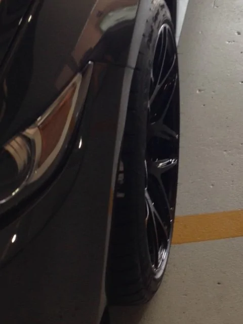

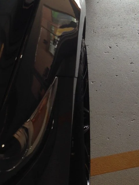

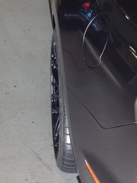

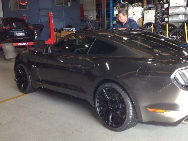

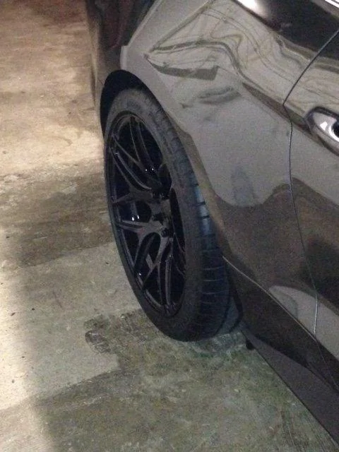

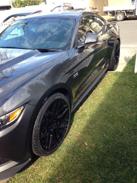

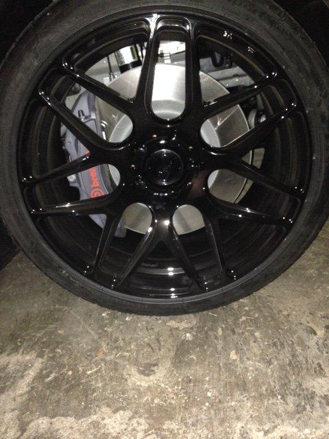

Had my wheels fitted today - JAX Bowen Hills - great folks - took a lot of care and traded my tyres. See pics below. 20"x 11" rear ET55, front 10" ET35. The front honestly is about as big an offset you can go. I have 275/35 MPSS front and 295/35 MPSS rear. The rear you could squib a few mm. in offset max. I saw ET50's ( Project 6 GR) and I think these are too aggressive. I also think some folks are over tyre-ing the cars.
These are Koya SF07. Same as MRR SF01. (SF02? guess what I saw at Koya's warehouse a few weeks back)
My wheels are Koya's std. SF07 Concave, not Deep Concave. I agonised between these and SF06, but you have to allow 3mm for the cap, and my figuring that left only the SF07 as offering suitable offsets for the rear wheels. This is just me. Folks can't go wrong either way. Great weight saving by the way. But, like 05STNG, my nuts are too big. You'll see in the pictures Koya supply the wheel nuts and need to have a solution that will manage nil to near all wheel boss machining (to get offset variations) which impacts stud length and hole depth. So if you want less protruding nuts, its a search - see others above that have been searching for the perfect nuts.
MPSS - much better steering responsiveness than the Pirellis from the get go.
Photos are i-phone sorry - I am mainly showing you the line up with guards here. Lowering is several weeks away - ordered Koni's from Race Consultancy - the last piece of puzzle on that front.
(In review the photos on my PC are right side up, but on web-site preview they are u/down, half rotated - so I hope this works.)
You may be wondering where are my rear MGP grey caliper covers? Well they touched some-where like a bike with cardboard in the spokes. Not flash. Koya claim our rear brake caliper is quite different to US models.
Oh - I paid extra for gloss black paint - brilliant finish and a nice touch is a spec sticker on inner rim that describes the spec of my wheels and notes the technician that cut them.

Hi FreeRein
These look sweet.
Whick Koni's have you ordered and how much will it lower the car as I have the the wheel arch gap issue as you

I like that wheel design. How much inside clearance do you have with the 11" +55?
I'd be interested to know what you think of the custom paint finish too?
I got some Koya Drift Teks for my XH ute and paid extra for custom colour and it honestly looks like someone painted them with a friggen spray can!? Plus it's already started to chip off!?!:frusty::frusty:

05STNG - the Konis are Yellow Sport adjustables. About A$1150 landed door to door. The springs that do all the lowering are BMR SP083 - go to the BMR site for all the info. These are about A$450 landed door to door. These lower it about 30mm front and 15mm rear. BMR offer a front only front that has a 30mm drop for US$120 a set plus freight which allows you to retain original struts etc. This is the cheapest way - almost same spring rate as std.
FIXR7 - I am very pleased with quality of wheel and paint job overall. I haven't been above 75klm hr yet - just passed 130 klms on the odo today. Paint job on wheels looks factory quality. The paint job was an outsourced job - Koya don't paint the wheels - they only do the machining as far as I know. They started as matt black wheels.
Spacing behind - I didn't look, but if you go to the wheels and tyres section on this site there is heaps of info and 12" and wider are possible with upto 345 tyres so there is no issue what-so ever with an 11"wheel. 11"x ET55 (GT350 MRR reps for a start) is a very common size with these cars in the US.
