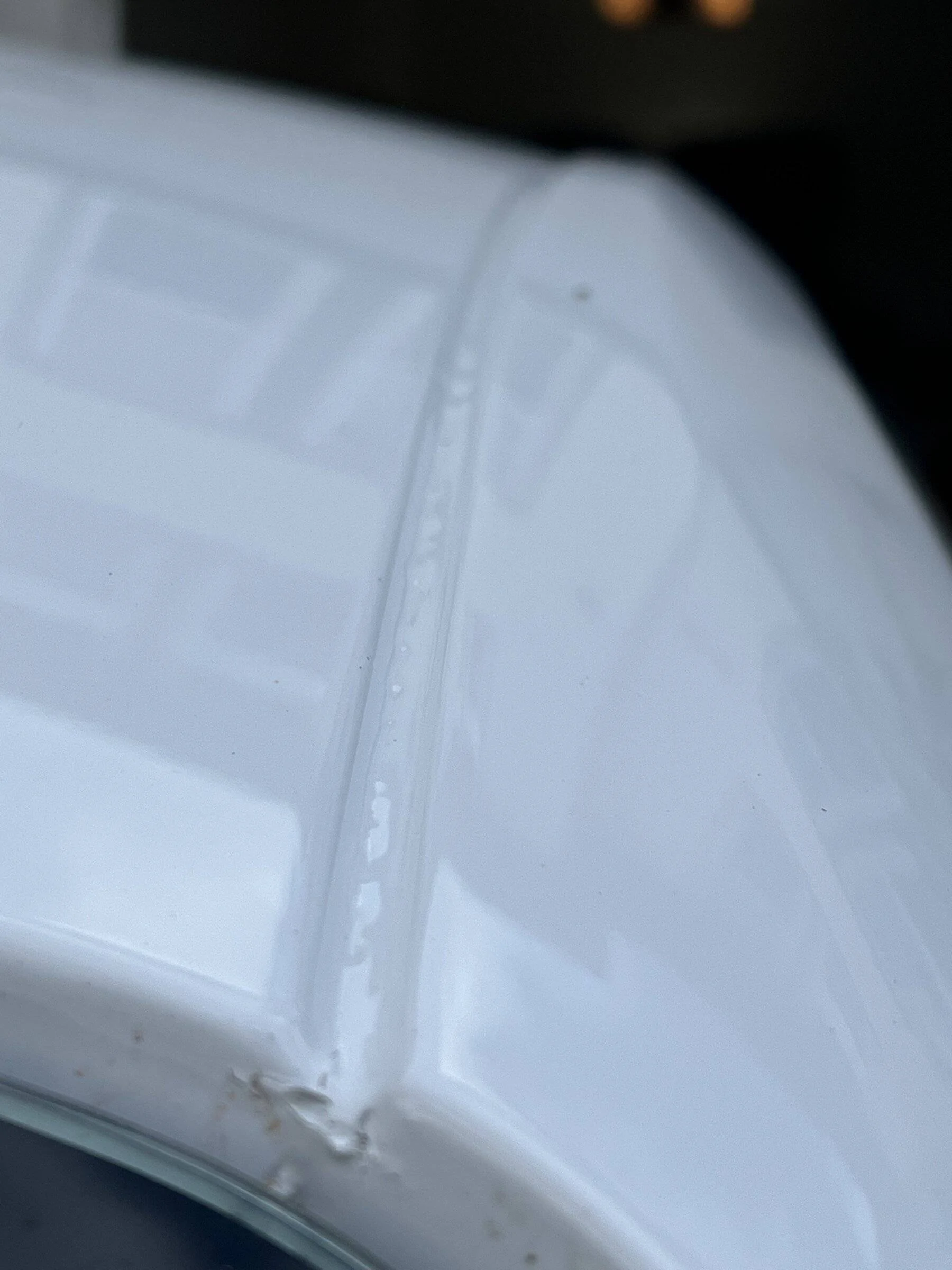

I've noticed this bubbling on the roof since I got the car in December. The car only has 4000 miles on it atm and is garage kept. I've had 2 other mustangs and this is the first one I've noticed this issue on.

I don’t think that’s your paint bubbling, I think that’s excess seem sealer under your paint ?

Yep it is! Took it to Ford and the repair shop. Will be covered under warranty, the catch is the whole car has to essentially come apart to fix that one section so i’m not sure if it’s worth it.
