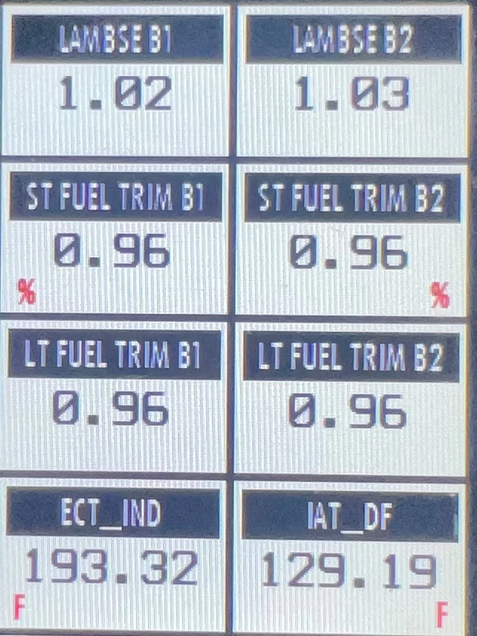

Managed to get an Sct x4 screenshot while the engine was running amazing. Screenshot was at idle and had been siting for a while which is why the intake temp is high.
does it look like I’m running too lean ?
It’s lean but I don’t think it’s that bad.
between 3-4% correction

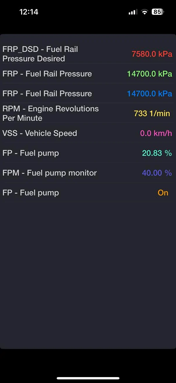

Do these figures look ok to anyone ?.
This was at idle. Why is the fuel pressure so high compared to specified ?

kpa to psi - Search
Hello; Been a while since I figured with KPa ( kilo pascals) so I had to look up the conversion. The numbers in your post come out very high. What have I missed?
sk47
Nov 12, 2020
6,924
3,204
North Eastern TN
Jeff
Hello; using the conversion link I get 7580 kPa = 1099 psi
14700 kPa = 2132 psi.

It stays like that until I rev the engine and then it settles down again.
On some other forums apparently is normal for tunes to do this and nothing to worry about.
How would I log the fuel pump duty ?.
anything I should be looking out for ?.

Hello; I gather you use a Sct x4 tuner to create a tune and also manage to get the readings you have posted. As I do not have experience with these tuners, I cannot say one way or another about the quality/accuracy of the readings. I do assume the tuner gets readings from the factory sensors attached to the engine. If such is correct, then a situation might exist where some sensor is out of spec and trusting the readings is possibly questionable. Regardless you are walking the walk by gathering data and evidence. Hopefully it will make sense someday.
The fuel pressure seems high, but it may be normal. A friends 911 T has mechanical fuel injection. An electric fuel pump feed lower pressure fuel to the high-pressure mechanical fuel pump system. I think direct injection engines run at higher fuel pressure. It would see the fuel system is running at roughly twice the required pressure. So this should indicate the fuel pump(s) are working fine. A question is where these readings taken during a period of the rough running which has been plaguing your engine??? If so, then a tentative but not final conclusion could be the fuel pump(s) are in good order.
A thing to look for is if the fuel rails hold pressure with the key turned off. Can you get such readings say an hour after turning off the engine?
