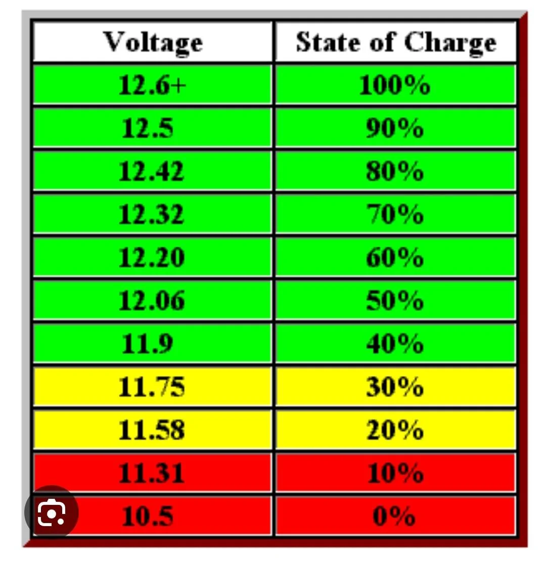

Yeh battery is good 14.7 volts when idling
12,5v you mean resting with engine switched off ?.
14.7V is the voltage the alternator is outputting, not battery voltage. To check the battery state of charge the car needs to be off and any "surface charge" removed. Surface charge can be removed by letting the car sit for a few hours or by turning on the headlights for about 10-15 seconds. Then measure battery voltage across the terminals. Here's a chart that gives you a rough idea of battery condition based on its state of charge.
