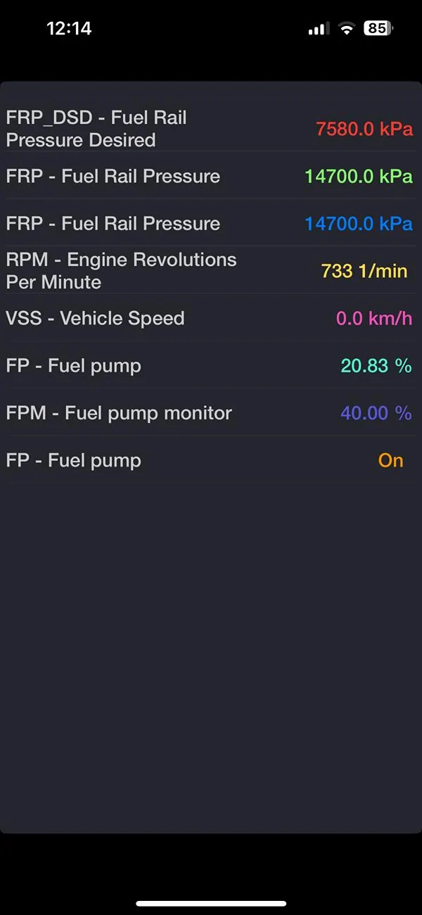

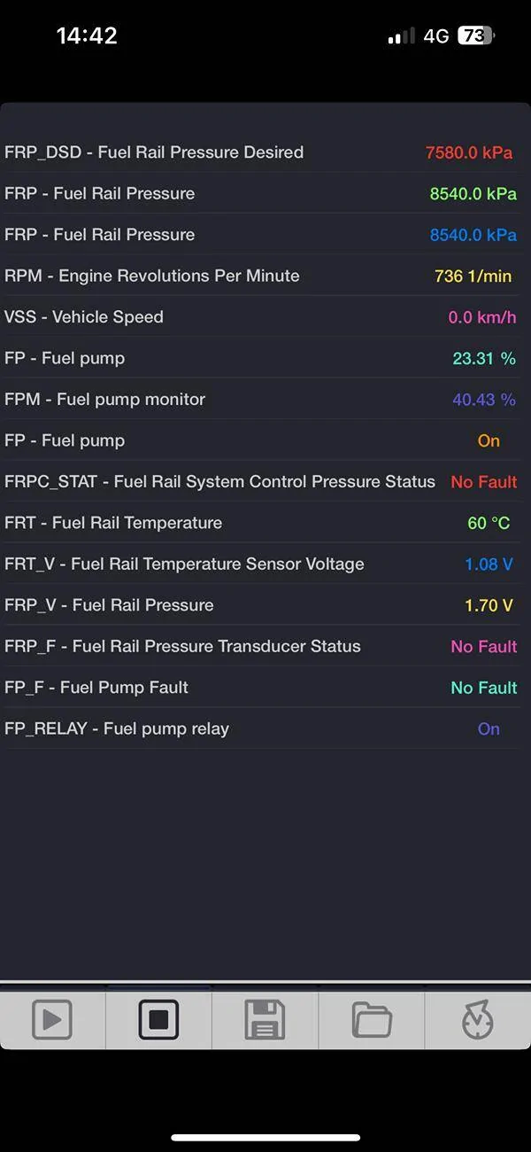

Hi Guys
I think I’m getting really close to figuring out this problem and just need some of your genius brains to help me track it down.
so I’ve managed to do a couple of runs and managed to catch it when it’s running really good and a little rough.
nothing has stood out as being a problem. However the fuel rail pressures seem to be different between runs.
on both runs they both peak the same and following the specified numbers, however when I pull over and let the car idle, when it’s running Rough the fuel pressure almost doubles what the specified is asking for and keeps rising.
when running good the fuel remains firm the same as specified. This may be why the car shakes a little at idle there is more engine noise?.
what would be causing this ?.
have a look at the two tables. Sorry I logged fuel pressure in Kpa.

Also fuel pump is running higher cycle when it’s running good too. Only by a little though.
Hello; Again, keep in mind I am not hands-on experienced with the direct injection engine. That said my initial take is the pressure relief valve may not be bleeding off excess pressure as it is intended to do. This is backward from the sorts of issues usually know for these valves. If such is the case it does sort of fit your symptoms.
The injectors work by spraying fuel into the combustion chamber. The amount of fuel sprayed is determined by the length of time the pentile valve is held open and the pressure in the fuel rail. The length of time is controlled by the ECM (computer). The pressure, my guess anyway, is expected to be constant. If the fuel rail pressure is too high, then too much fuel is being sprayed (rich).
Might account for the hot cats reported.
Last fuel pressure regulator I replaced was many years ago on a F-150. Not a bad job on that truck. Did not cost a lot back then. Unfortunately, did not fix the issue so I put the stock regulator back on and kept throwing parts at it. still have that pressure regulator in a box. As can be expected from life after lots of work and several hundred dollars of parts I got the truck fixed just before it was totaled.

What’s the gdi blend % at the time wien the pressure creeps up?

The gen3 measures fuel pressure and compensates by altering injector pulsewidth. The gen3 will run perfectly fine in a very large range of fuel pressures.
