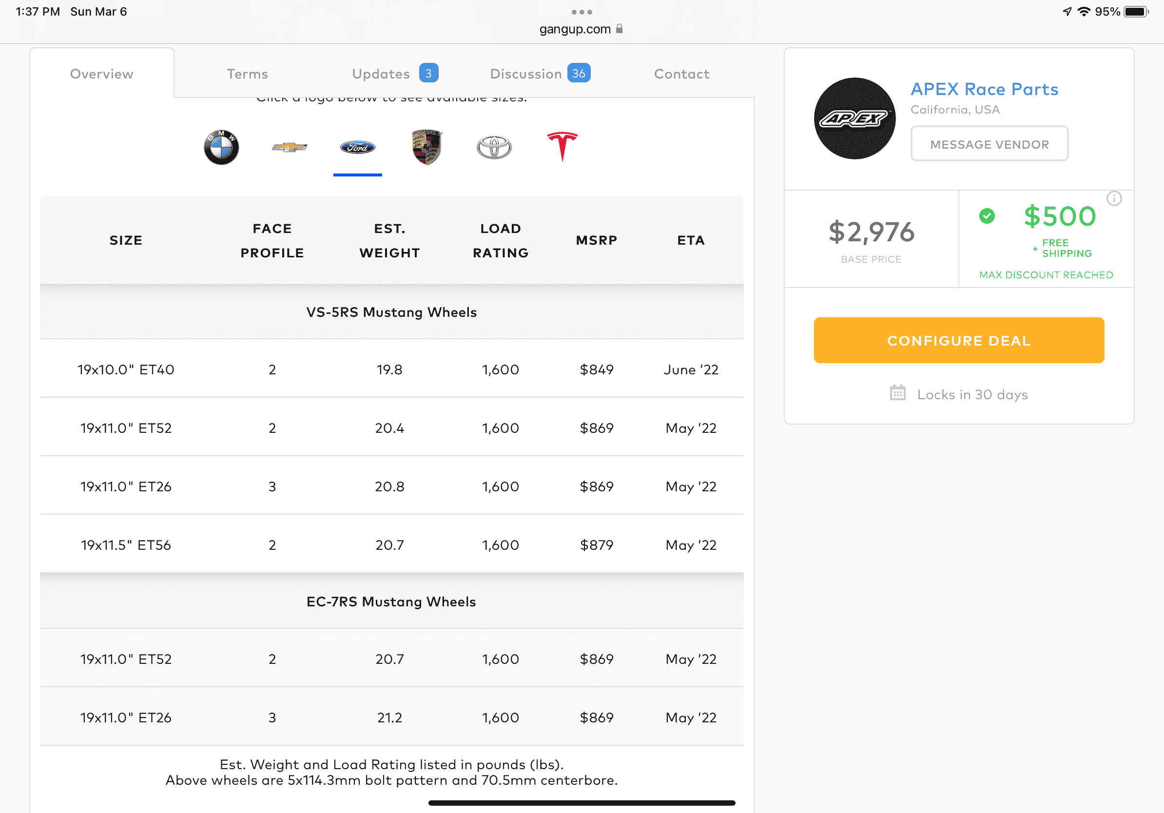

Wondering if anyone is considering the Apex wheels VS-5RS group buy. I want to have a separate set of track wheels and these look pretty good and sturdy.
The width options are 10, 11 and 11.5". I'd be inclined to go the +0.5" wider option, (11" wide front and 11.5" rear) but I'm wondering if this is a "no particular advantage" situation. I don't think you can really run much wider tires up front or in the rear. Apex says the + 0.5" option requires a "track alignment" but don't specify what that is. My current track alignment is -2.5 front and -1.7 rear, not sure if that's enough or not. There doesn't appear to be all that much room in back for a much wider wheel and/or tire combo when I look at the rear on a lift.

I was checking about those wheels but decided not to, because it means changing the tires to a different size. This is the link to their fitness guide: https://support.apexraceparts.com/h...5483093-S550-Mustang-Wheel-Tire-Fitment-Guide. I found that the only way to keep the OEM Mach 1 tire size (255x40x19 front and 275x40x19 back ) is to have their 19” x 9” with 34 mm offset in the front and 19” x 10” with 40mm offset in the back. As you can see from the screen shot, those size wheels are not available in the group buy. They were available in the SM-10 group buy but I don’t really like that design.
