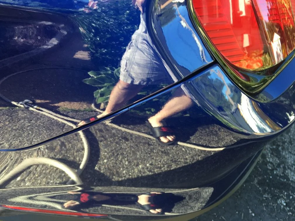

Anyone fixed the rear bumper gap?
RockStang
May 15, 2015
123
1,276
216
AA county MD
Joe
2016 GT Whippled
This looks terrible for a brand new car. I know other have had the issue. Just wondering if anyone has removed the rear bumper and been able to fix whatever is causing this? Probably going to take it off soon.

damn thats bad .. id take that right back.. its prob the plastic hold ins on the side lower qp behind the bumper..thats the only thing that holds that part in

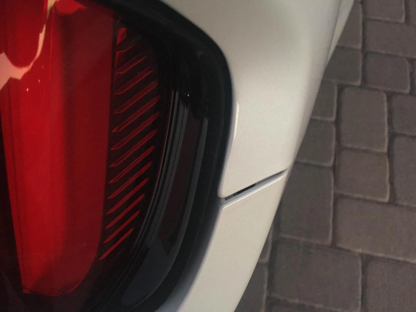

Yep. My '17 had it, too. Dealer popped bumper cover off and got it to look better. Said to get it perfect would require additional effort maybe including repaint it. I told them good enough. No need to open more worm cans.
Here's what I had. I think the lighter paint showed more gap but it's still unacceptable. Ford's been making cars longer than most... should have this stuff nailed by now.

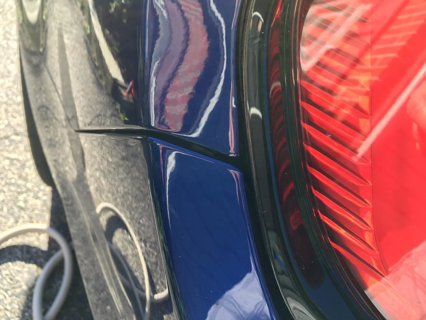

Super common issue, they seem to be aligned improperly (one side has a gap, other is tight). I've left my alone for now, kind of terrified of the dealer making it worse. I may eventually drop the bumper to do an exhaust, but ya, just looks like an alignment thing.

i must have bought the only gt with no gaps in any panel.. lol .
its a super easy fix.. just plastic track like hold ins.. pop the tails out and look down inside the side of the bumper you can see if it grabbing the plastic or not..

Damn still having these issues three model years in. Like gtain said mine is perfect on driver gapped on passenger. Same with front bumper. Dealer said that one is warped.

Just got my 17 and I can see one of the clips not clipped in on mine.
It seems like they did fix the bumper being too small issue as mine sits very flush to the metal on the side that's fully clipped in.
I think it's more of a installation issue.
