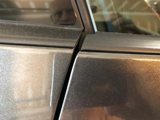

Don't know why it took three months to notice, but the passenger door on my '18 is misaligned. Can this be tackled on my own or is a dealer trip necessary?

Take it in.

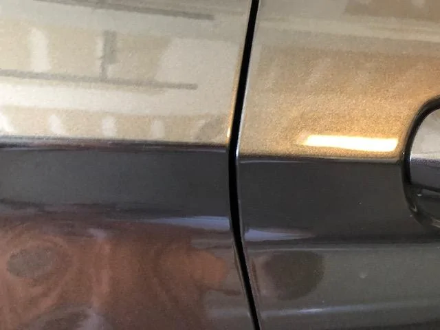

It bothers me because it breaks up the character line. The driver side is perfect.

I'd take it in. If you adjust it, you would also have to guarantee the window lines up correctly so it doesnt leak. And if you do take it in, make sure they check the window fit afterwards also.

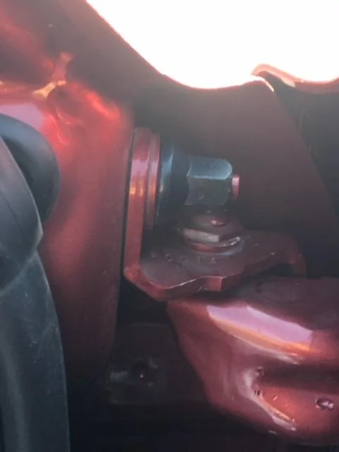

It's usually a matter of loosening the bolts on the door/body and aligning it and tightening them back down.
It is definitely a 2 person job . I'd have the dealer do it since it's a warranty item.

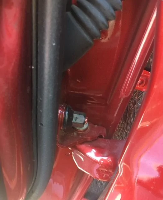

Those bolts look hard to get to. Anyone done it without removing the fender?

Actually looks simple , loose bottom , tighten top big black bolts.

But when you loosen them, is there room to adjust them? Do they slide in a slot or something?
