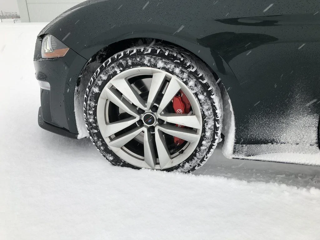

    I have four 9 x19 Ford Performance Mustang wheels with 245 Hakkapelittas on all 4 corners

    Are you sure those are 8.5 and not 9? I have 4 boxes of them in my garage and they say 9in

    You're right, I: just checked - they are 9" wide.. I run Hakkas on the Mustang and BMW; studded iPike's on my 4WD Ram 1500. I only put 3,000 miles a season on the Hakkas, so wear is unknown. I think the non-studded Hakka's are as good as the studded iPikes; but it's been years since i've tried Blizzaks. I think if one runs Michis, Blizzaks, or Hakkas you can't go wrong- less so with Pirelli snow rubber. I have a brother in the tire biz and get a great deal on the Nokians :-)
