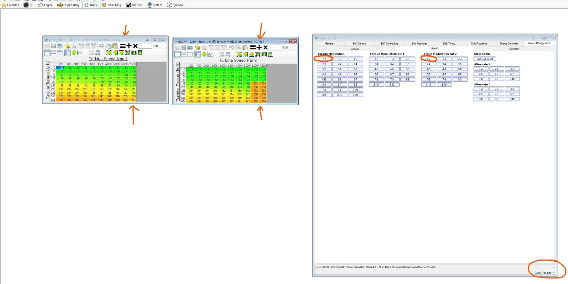

I’ve been doing the one thing at a time approach, which I’m sure is the only way to truly isolate whether or not the desired affect was obtained. Lately my pursuit is trying to pull timing on the shifts to see if that helps with trans longevity. I think I see it pulling timing in the log, but I’m not 100 %. I think it happens so fast that the time line in the log doesn’t Match up to when the timing is actually being pulled. Perhaps if log less pids the timing of everything will be more accurate

If you’re specifically working on one area like transmission tuning make sure you have a config file set up just for that with only the pids you need.
And you can change the polling rate of how fast individual pids are hit by the scanner.
On the left is Base aka Alt 0 aka "shift character configuration” 0 (normal drive), and on the right is Drag aka Sand aka Alt 2 aka "shift character configuration" 2 (drag mode)
Drag mode pulls little too no timing and base pulls as much as needed to only allow 391 engine torque
