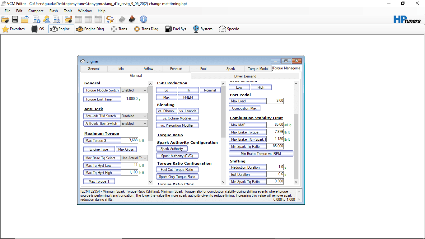

I believe I figured out how to pull timing on the shifts. my most recent datalog shows timing dropping down from 22-ish to around 6 or 7 degrees on the shift. Again I'm just trying to prolong the life of my trans. I'm sure et would be affected, but I'm not really tracking the car right now so I'm not too worried about it. this was the setting I modified. in the lower right hand corner:

I looked at the torque modulation settings in the trans section, but wanted to try this first as this appeared to be much less complicated. Also torque modulation is currently disabled in my tune and I was concerned that enabling it could potentially open a new can of worms
