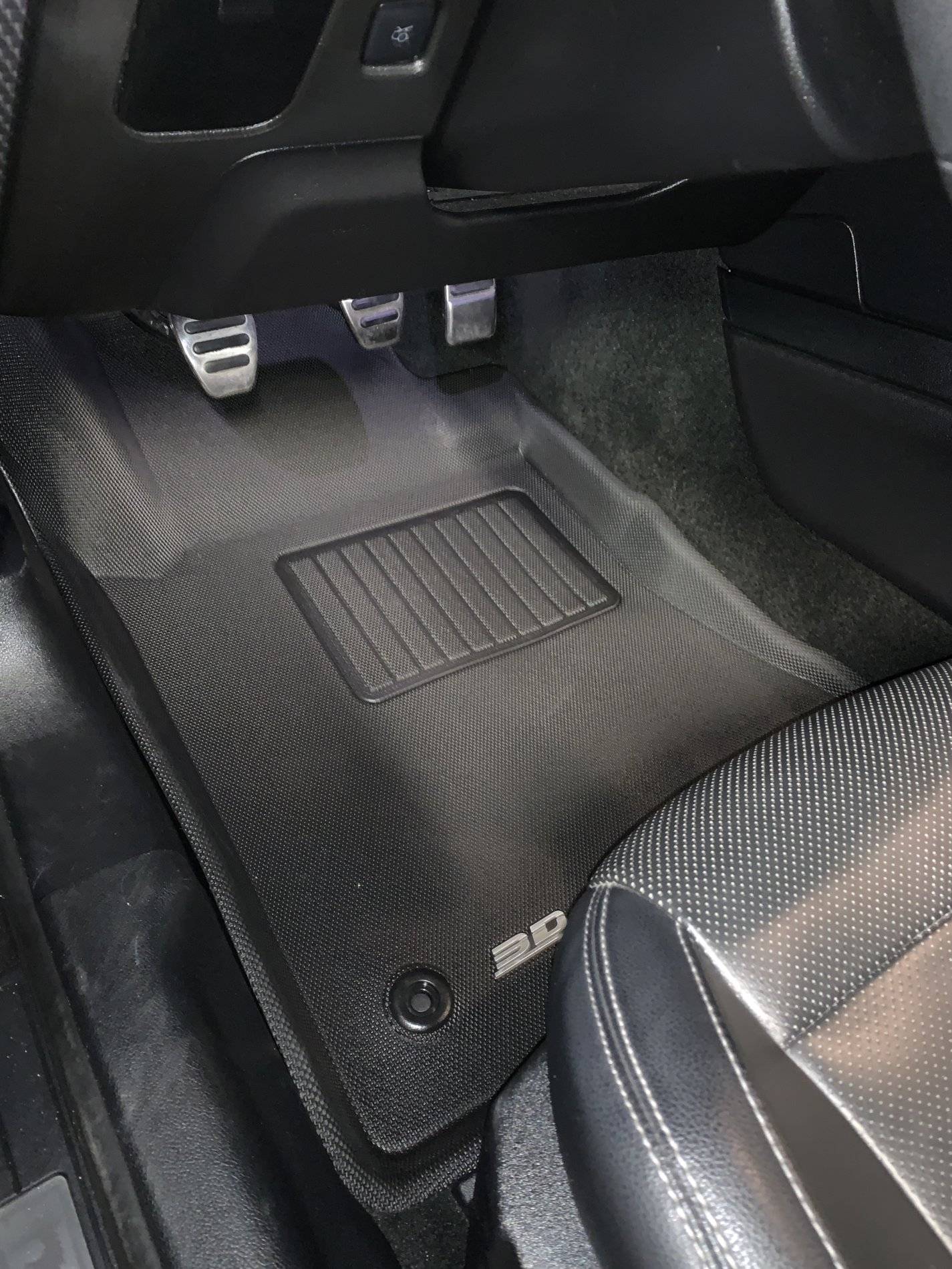

3d all weather mats

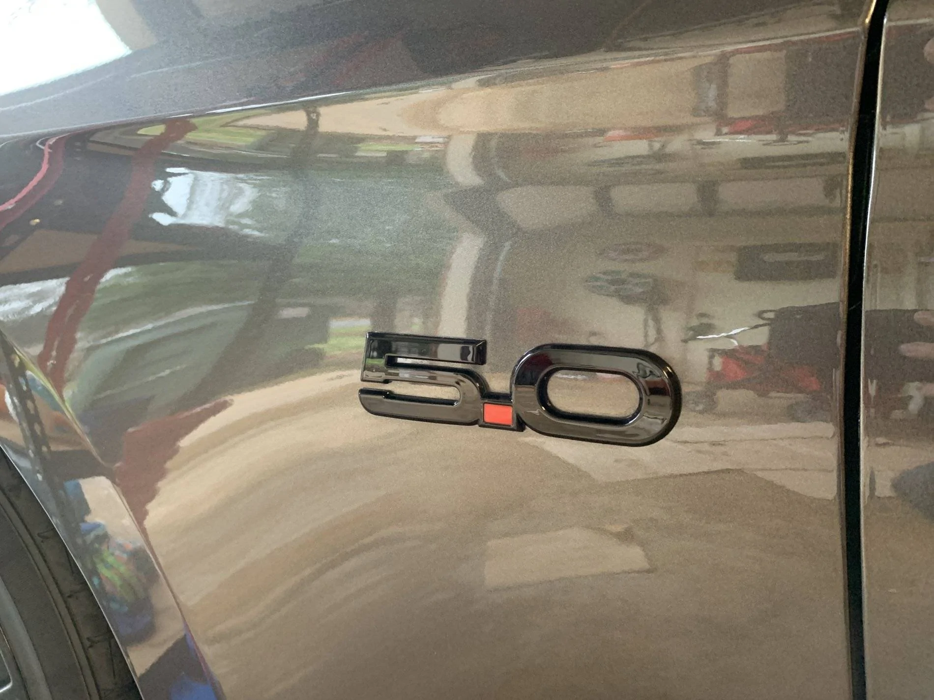

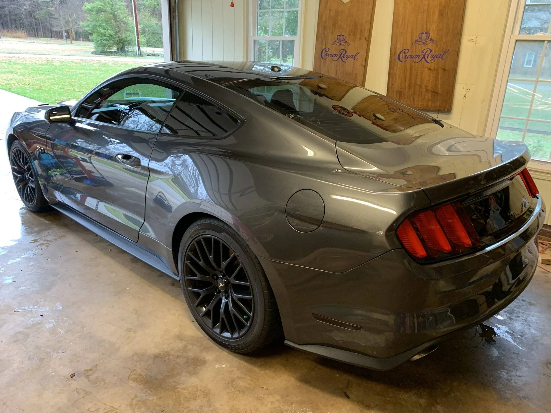

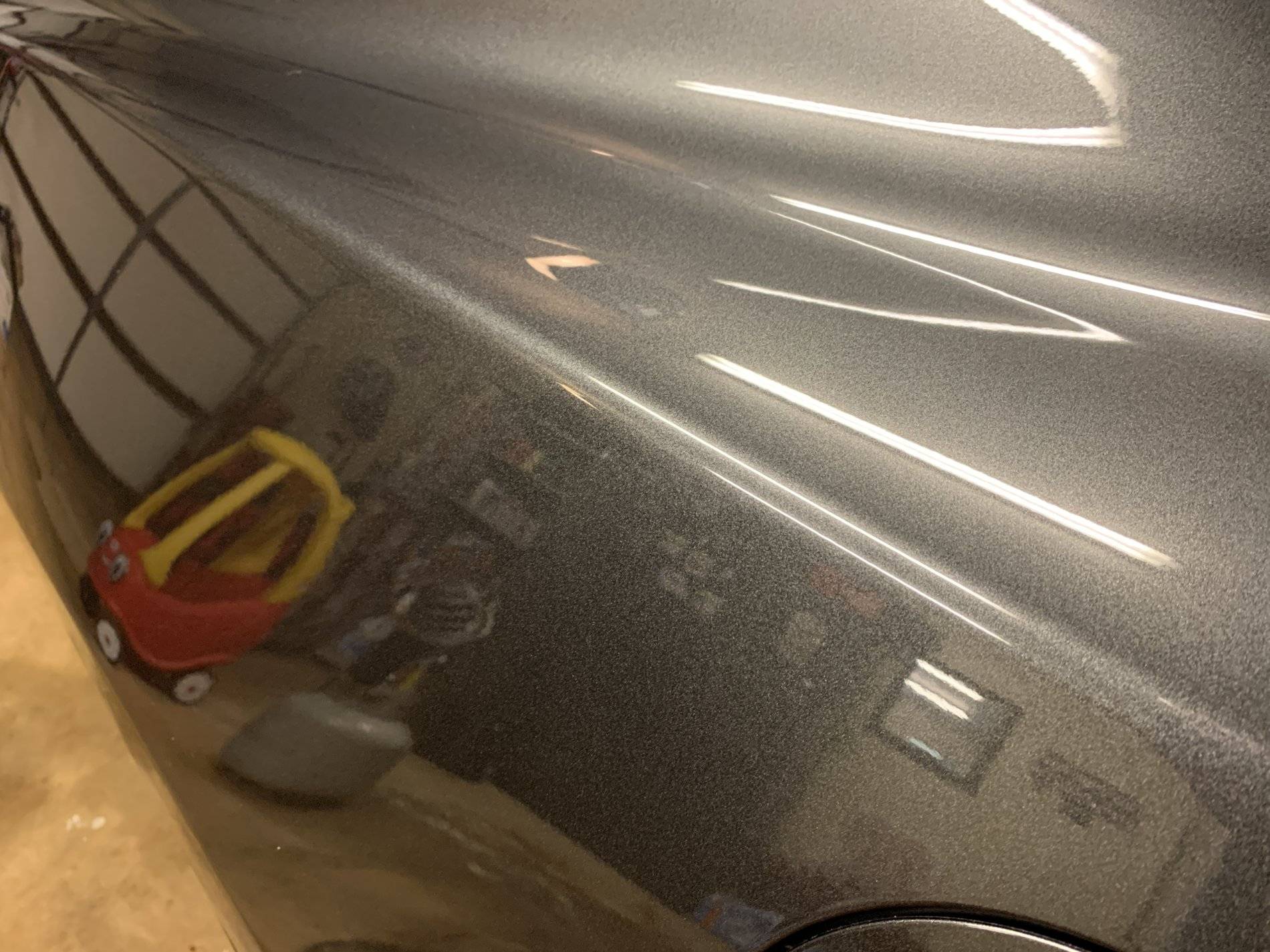

Busy day today! Wash, clay, polish, wax. Still need to do the wheels but another day. Installed black 5.0 badges, new decklid, and black lug nuts. Stock lugs were trashed.

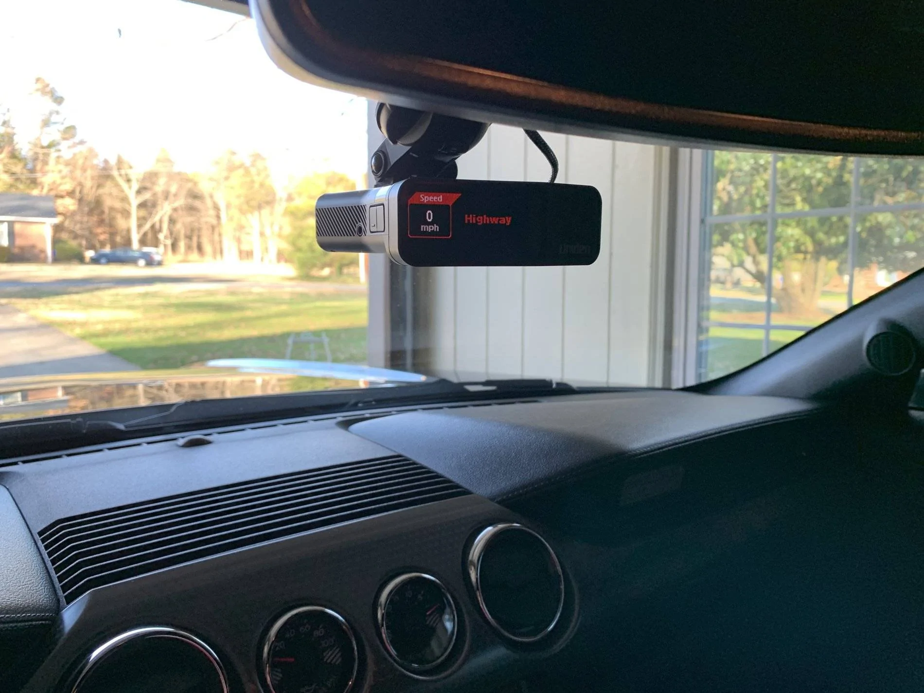

Uniden R7

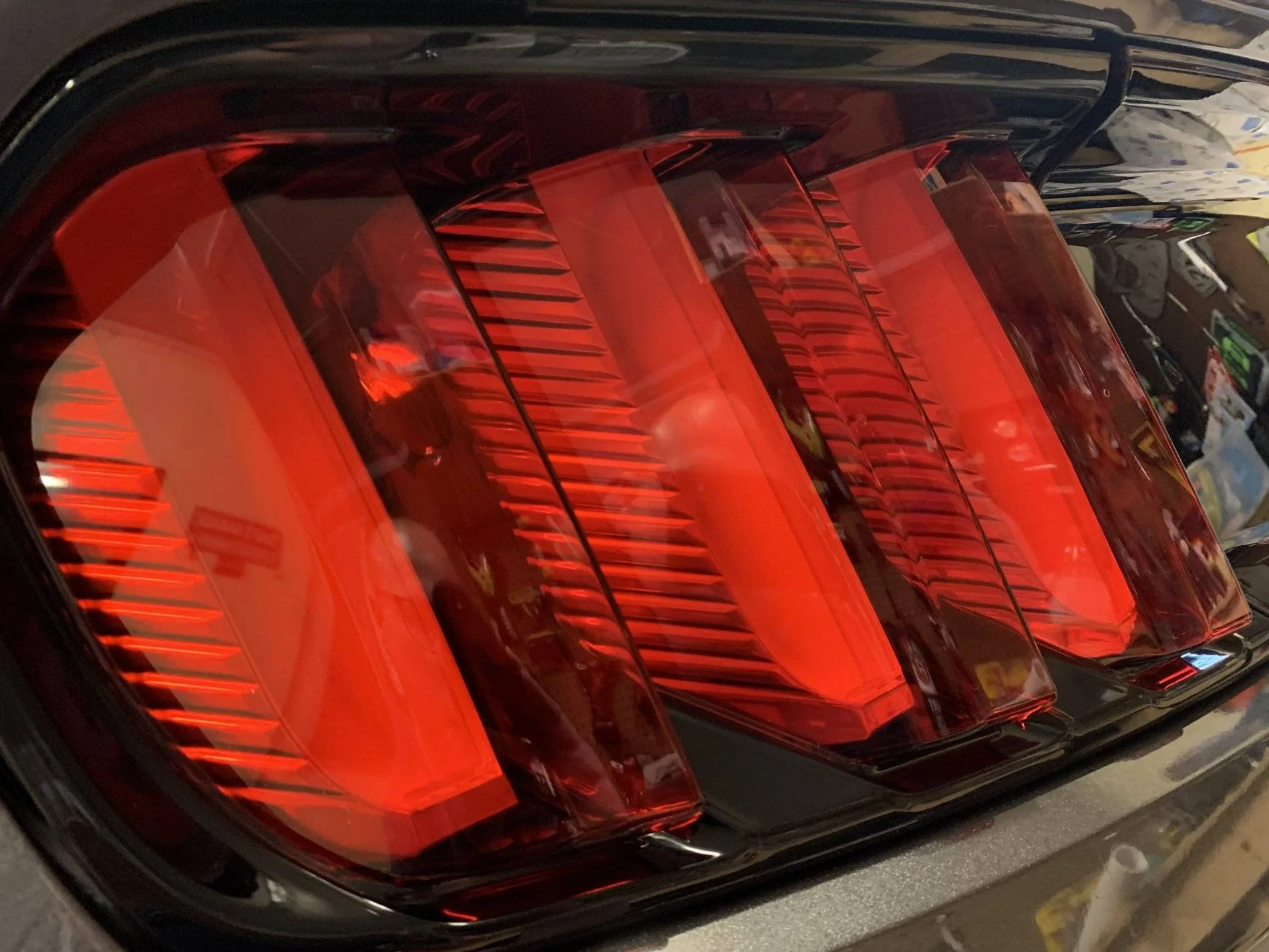

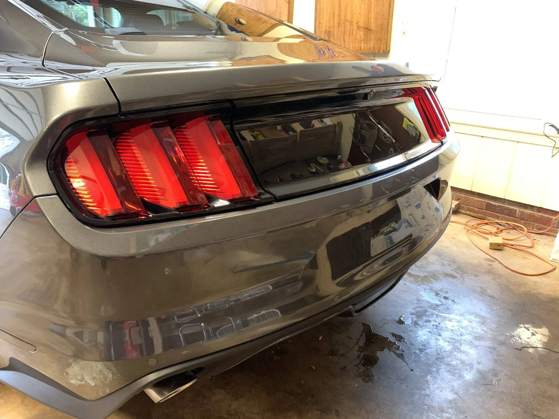

what you do to get them tail lights clear?
AnthonyL
AnthonyL
Dec 4, 2019
Salisbury, NC
Anthony
2017 Premium GT
Just used an all in one polish from Chemical Guys with a white 3" pad on the DA. Careful not to hit the lights with the da and worked it on a slow to medium speed. You could most likely get good results doing it by hand as well I just already had the polisher out.

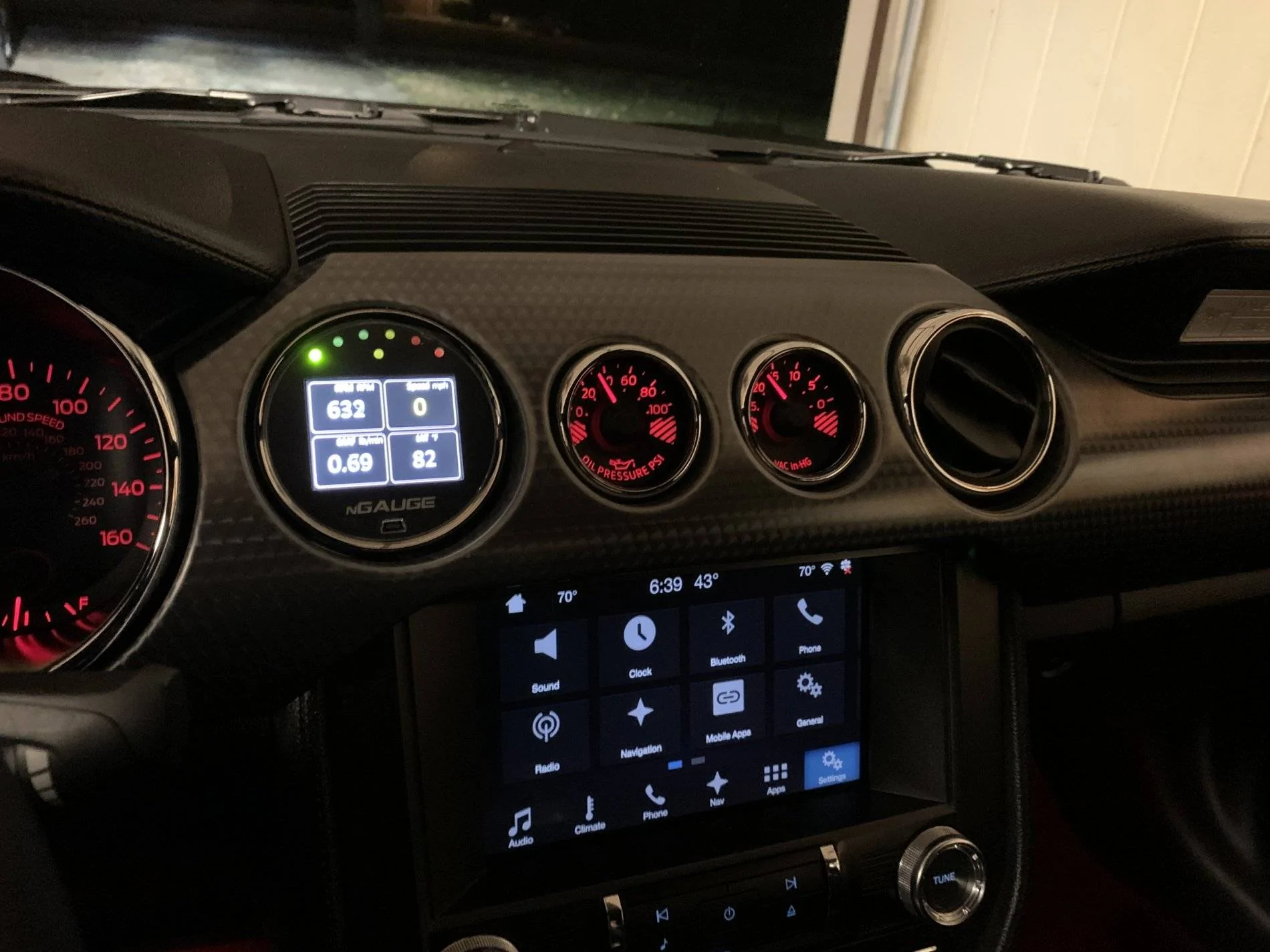

Nguage installed and just started first run with Lund Flex-fuel tune!

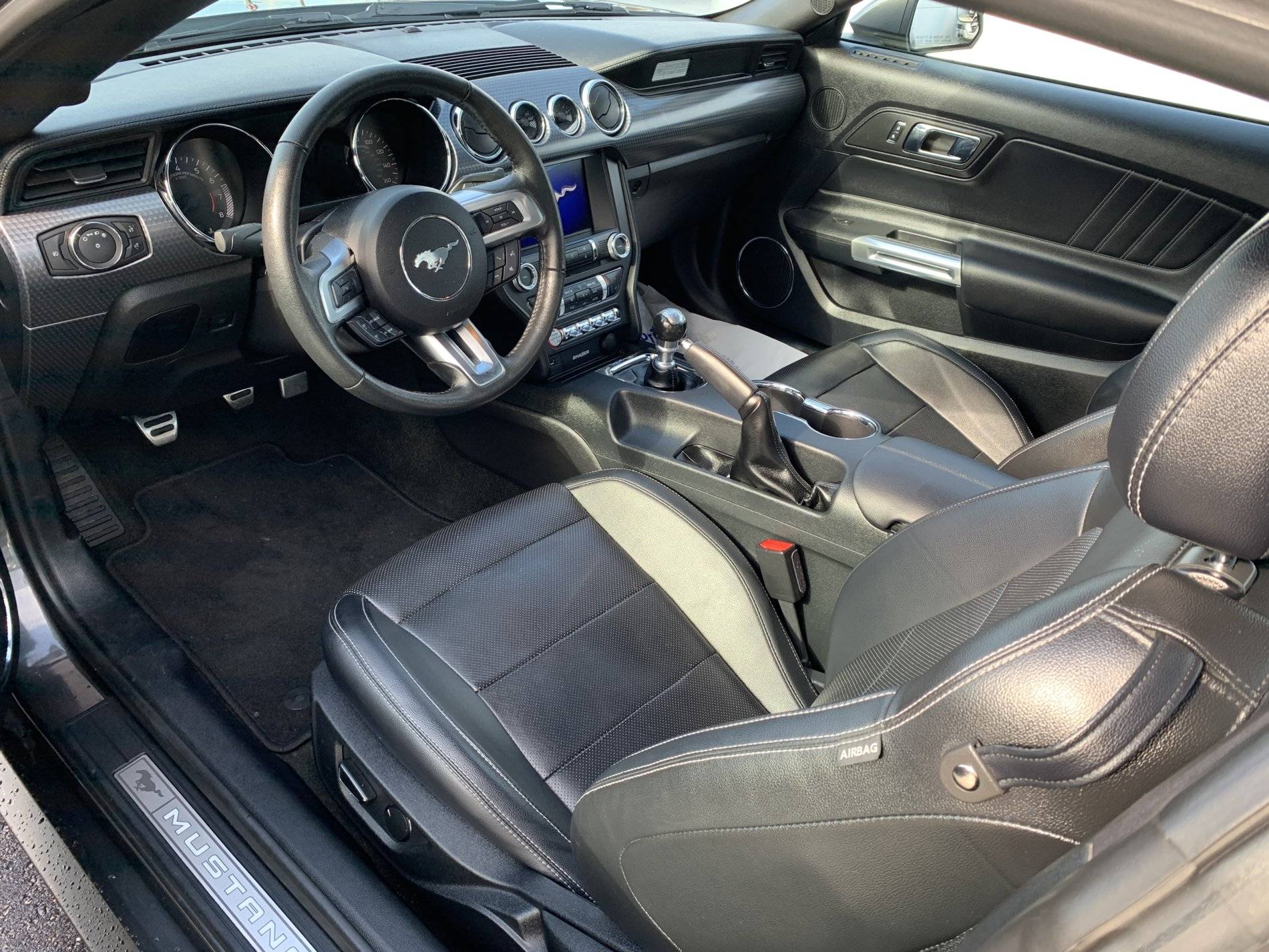

Boomba Shift knob installed. Still waiting on the shifter to come in.

That infotainment center. Is that the OEM part for the 2017 or is it after market. I likes it.
AnthonyL
AnthonyL
Dec 4, 2019
Salisbury, NC
Anthony
2017 Premium GT
mare you speaking of the screen where the air vents are? That is aftermarket. Lunds Ngauge for tuning an viewing parameters of the car. The larger screen below in the center is the factory touchscreen radio that comes in the premiums and up I believe.

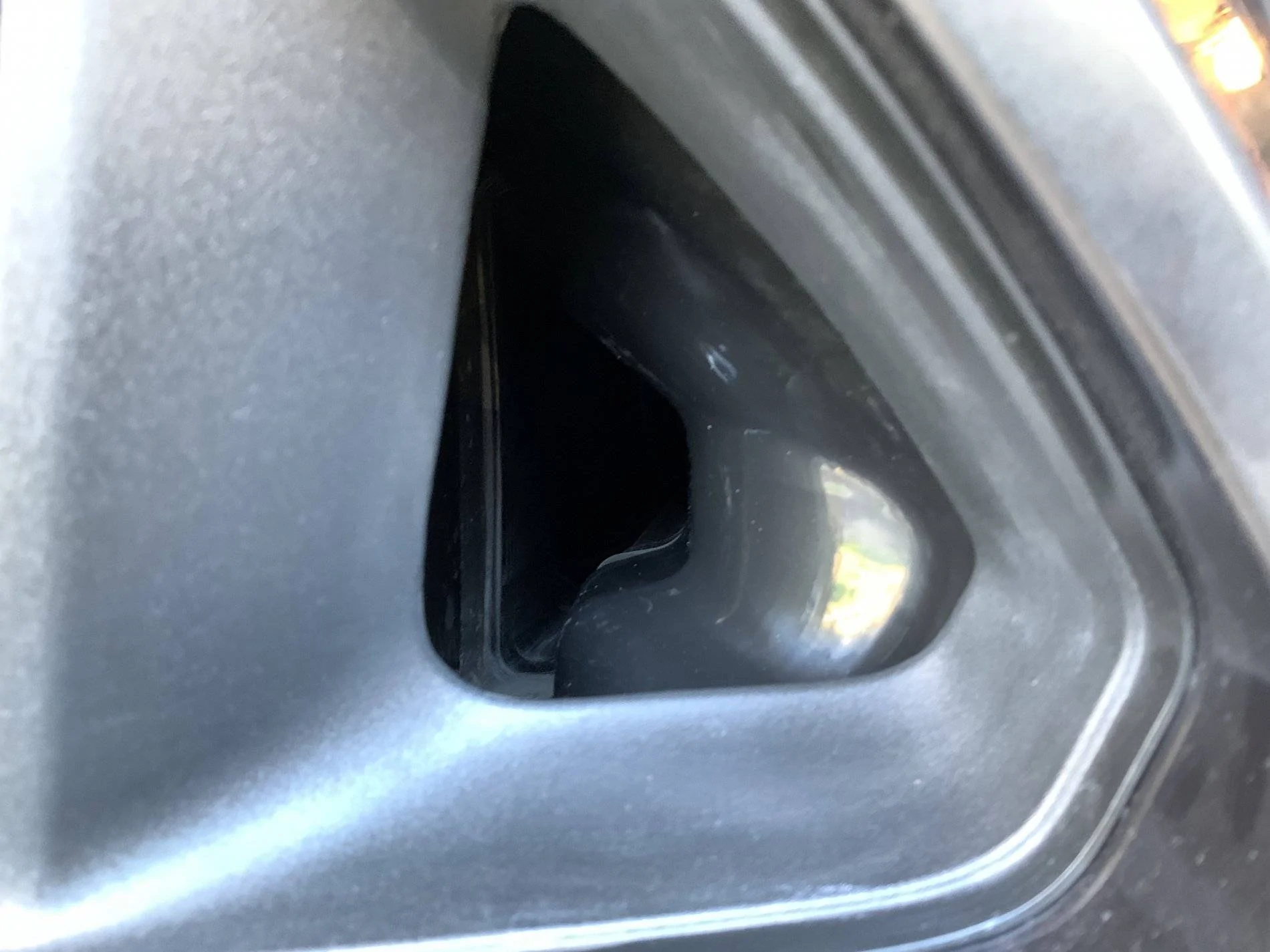

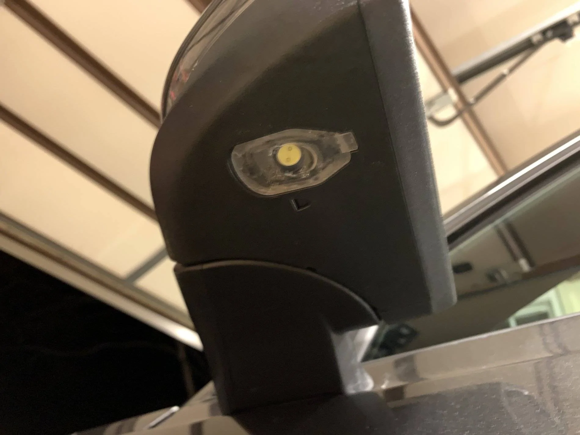

My pony puddle likes were looking pretty bad an honestly wasn't a fan of them in the first place. So I took them apart and made my own puddle like. I personally think it looks a lot better and more usable light.

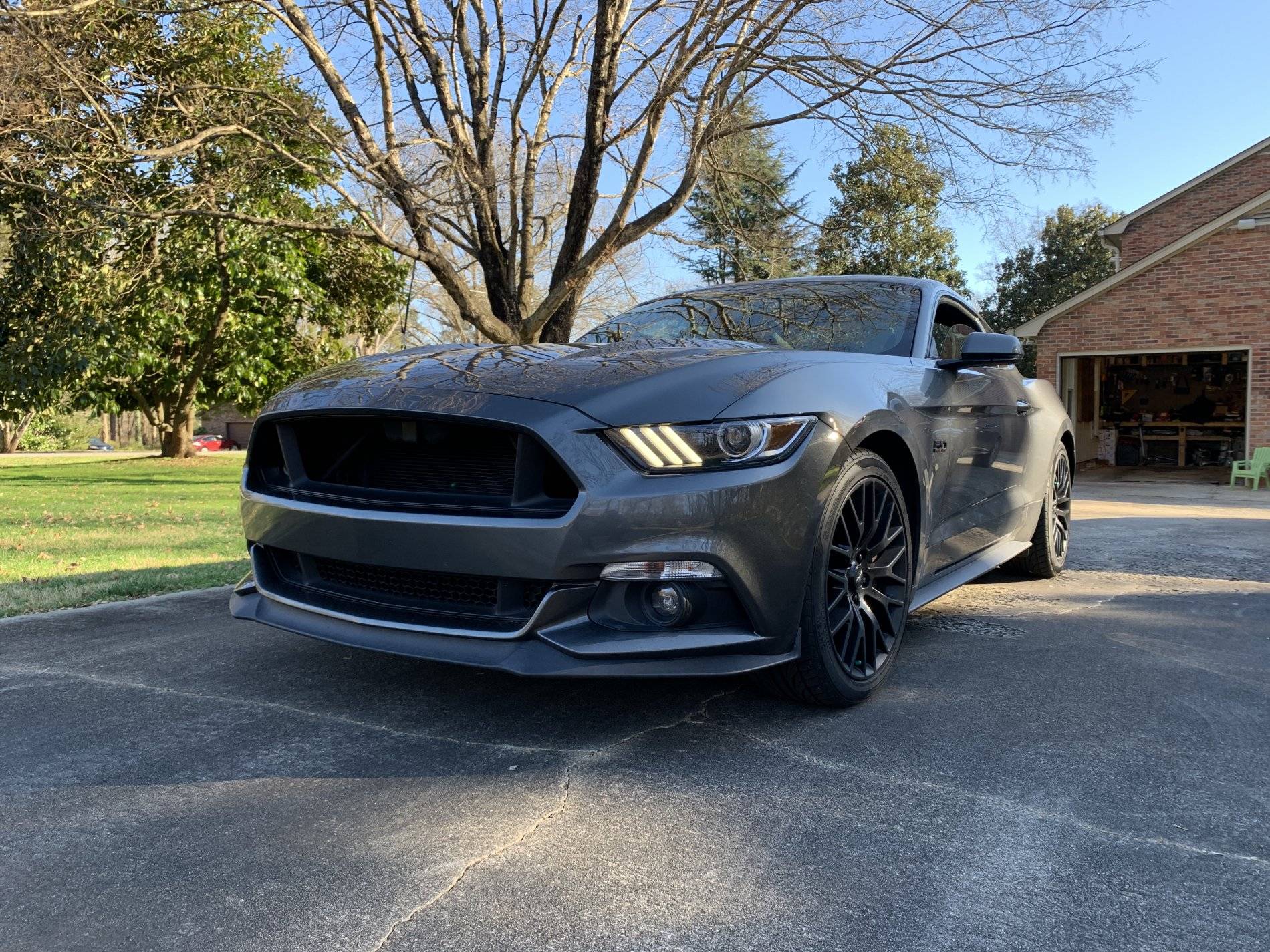

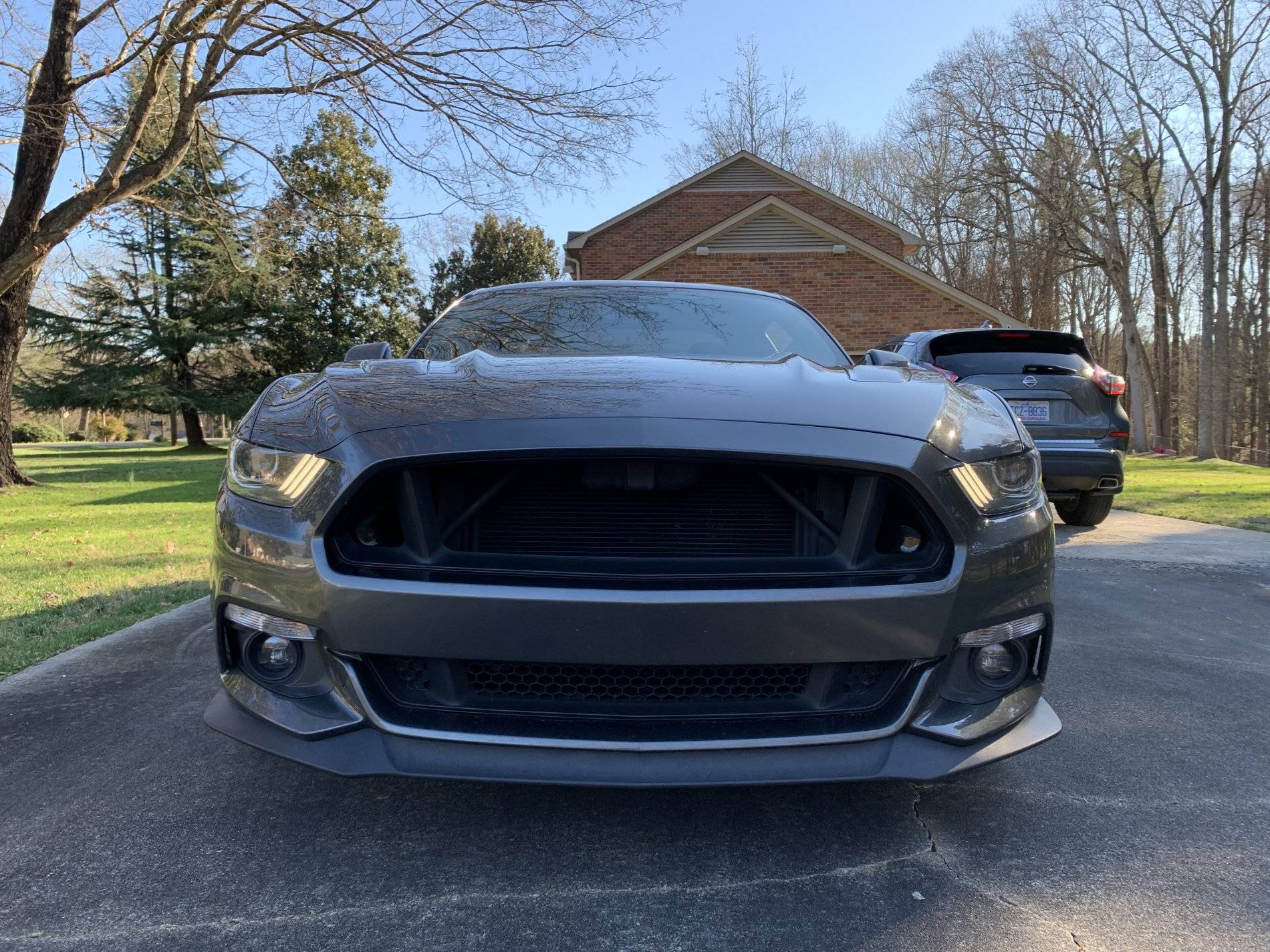

Did the upper grille delete and installed driver an passenger side Velossa Big Mouth intakes. Everything went pretty smoothly with the exception of me breaking my passenger side bumper clips. I plastic epoxied them back on and the bumper is holding but its not really clipped in there so I may need to do something else about it. Before the in Big Mouths, my AIT temps were 6 to 8 degrees above ambient. Now they are 2-3 while cruising and 0-1 at WOT.
I always wondered if those Vellosa intakes where worth a damn. Now seeing what you got I believe I will buy myself one.
Yea I was skeptical myself but a forum member had a super deal on the pair nib figured why not. Now that I have them I would highly recommend doing at least the driver side for the intake. The other is ehh only if you want too or you get a good deal. Unless you plan on going with colored ones then IMO you have to buy both to match.
