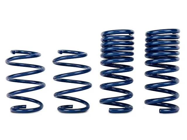

is the R springs are linear,
I'm gonna be pedantic and correct this. The R are linear front springs, but the rears are a dual rate, as are the FP rears (not progressive). The FP fronts are also linear, FYI.
On the left: linear rate
On the right: dual rate
