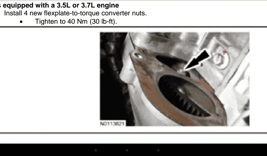

So only part of drivetrain replaced was the engine, correct?
It was originally a 6R80 setup?
Did you remove the bell housing inspection cover and check to make sure the torque converter is bolted to the flex plate like others have said above AND make sure those bolts are tightened all the way down?
If one of those bolts are sticking up the slightest, it’s going to jamb the torque converter...
