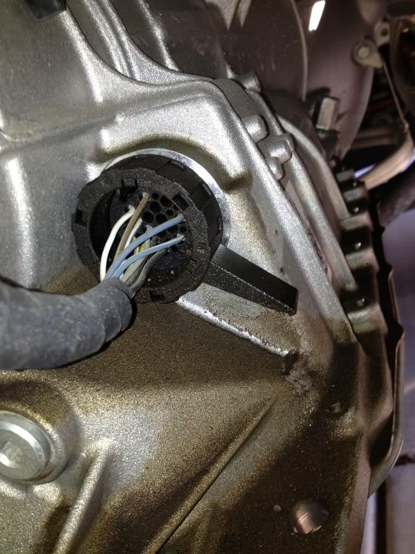

Juben
Jan 29, 2015
35
2,519
809
Chattanooga, TN
Justin
2015 EcoBoost Mustang (AT) w/PP
On the passenger side of the transmission, there's a plug from the wiring harness that needs to be plugged in. Make sure that hasn't been left disconnected. That could very well cause what you're describing.
Juben
Jan 29, 2015
35
2,519
809
Chattanooga, TN
Justin
This is on a F-150 but it looks the same and would be in the same general area.

2018 shadow black mustang GT
Ya I plugged that in, I missed it the first time but ended up getting it cuz I didn't know where the hell it went until.i found a wiring schematic.
