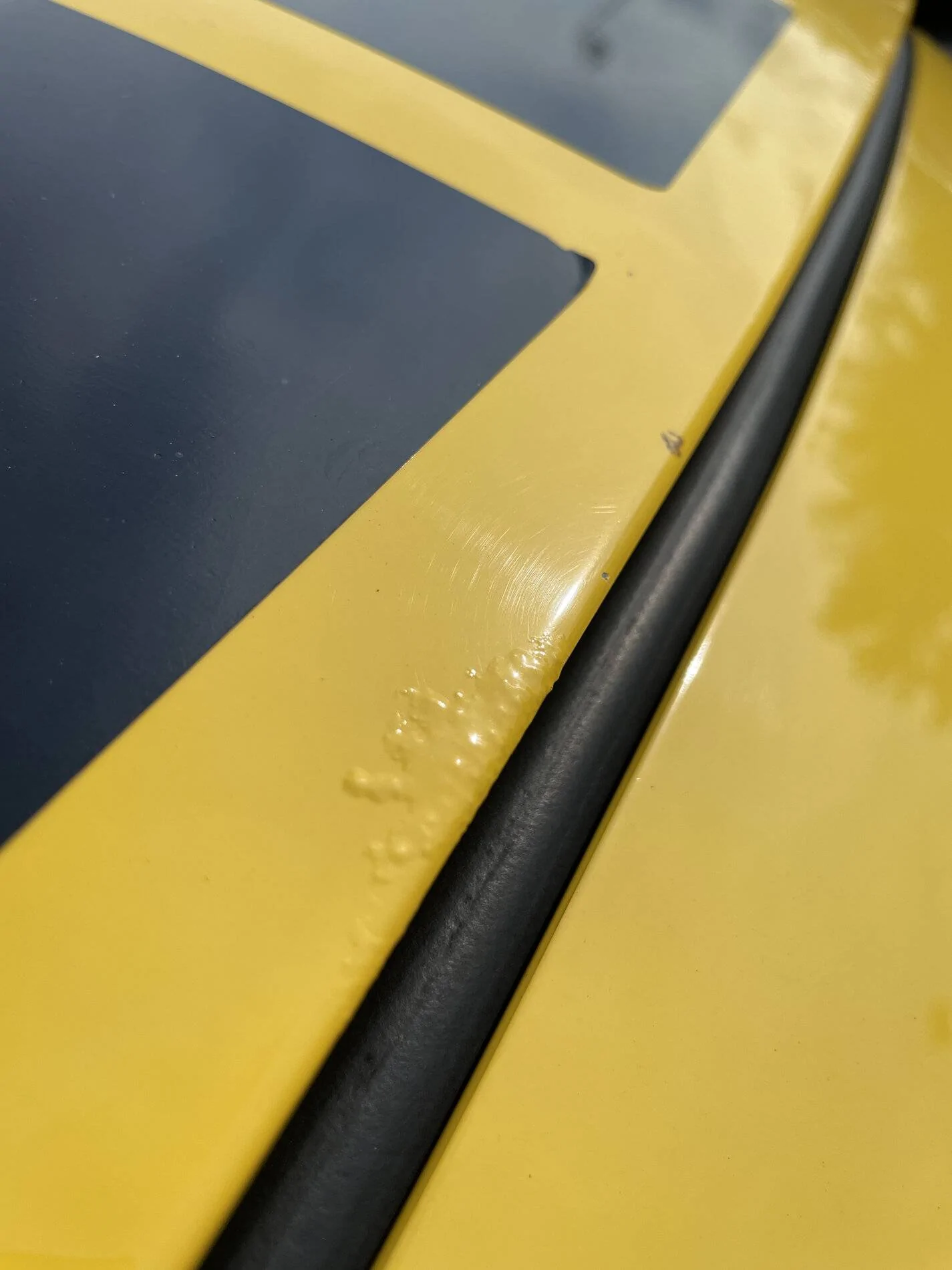

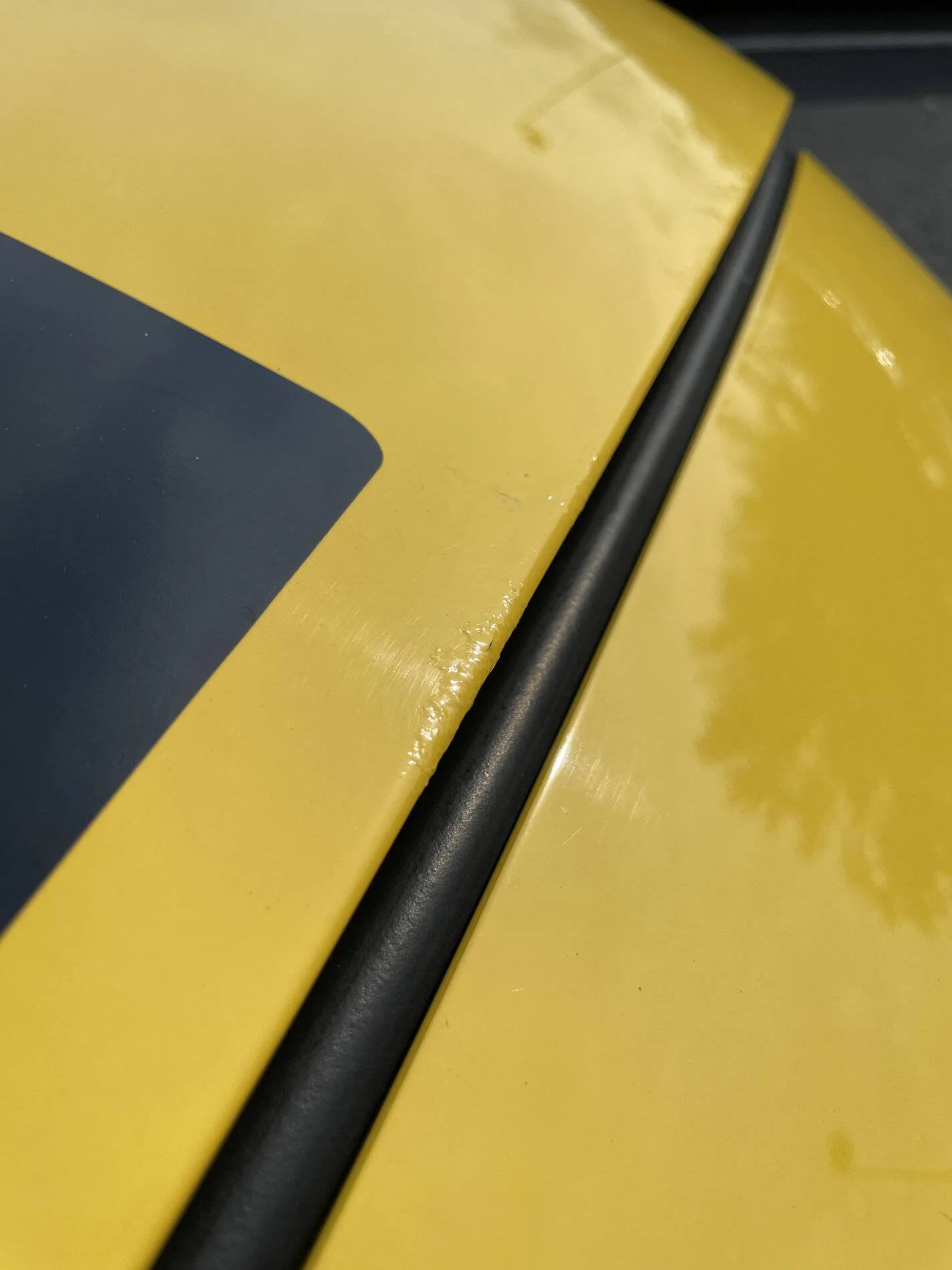

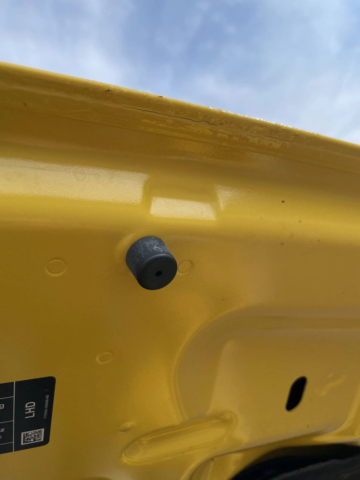

Hey gang!
A couple months ago my 2017 GT Premium [32k miles currently] started developing the typical rust around the front edge of the hood, and some in the passenger front fender. I went to the dealership a couple of weeks after I noticed and the service manager started giving me BS excuses to not cover it; however, a godsend seller pulled me apart and told me to come back with a printout of the TSB and to mention the 'body panel perforation' warranty.
So I came here and did some research, printed out a copy of THIS TSB, and went back to the dealership with the printout and spoke with the service manager once more, mentioning the TSB and perforation warranty and she agreed to make a request for warranty. The new hood and fender should arrive next week.
TLD/DR; Don't get discouraged if the dealership declines to cover your hood rust issues, just go back, better prepared and you'll have way better odds.
That's all.

Do you happen to have pictures of the rust and the locations. Makes me want to go check mine 🤦🏼‍♂️

I have a spot on my hood and trunk lid that I will have looked at soon. Just gotta find the time to deal with it and the headache being down a car will be.

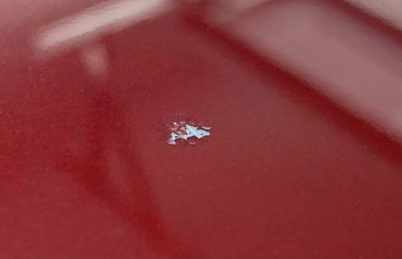

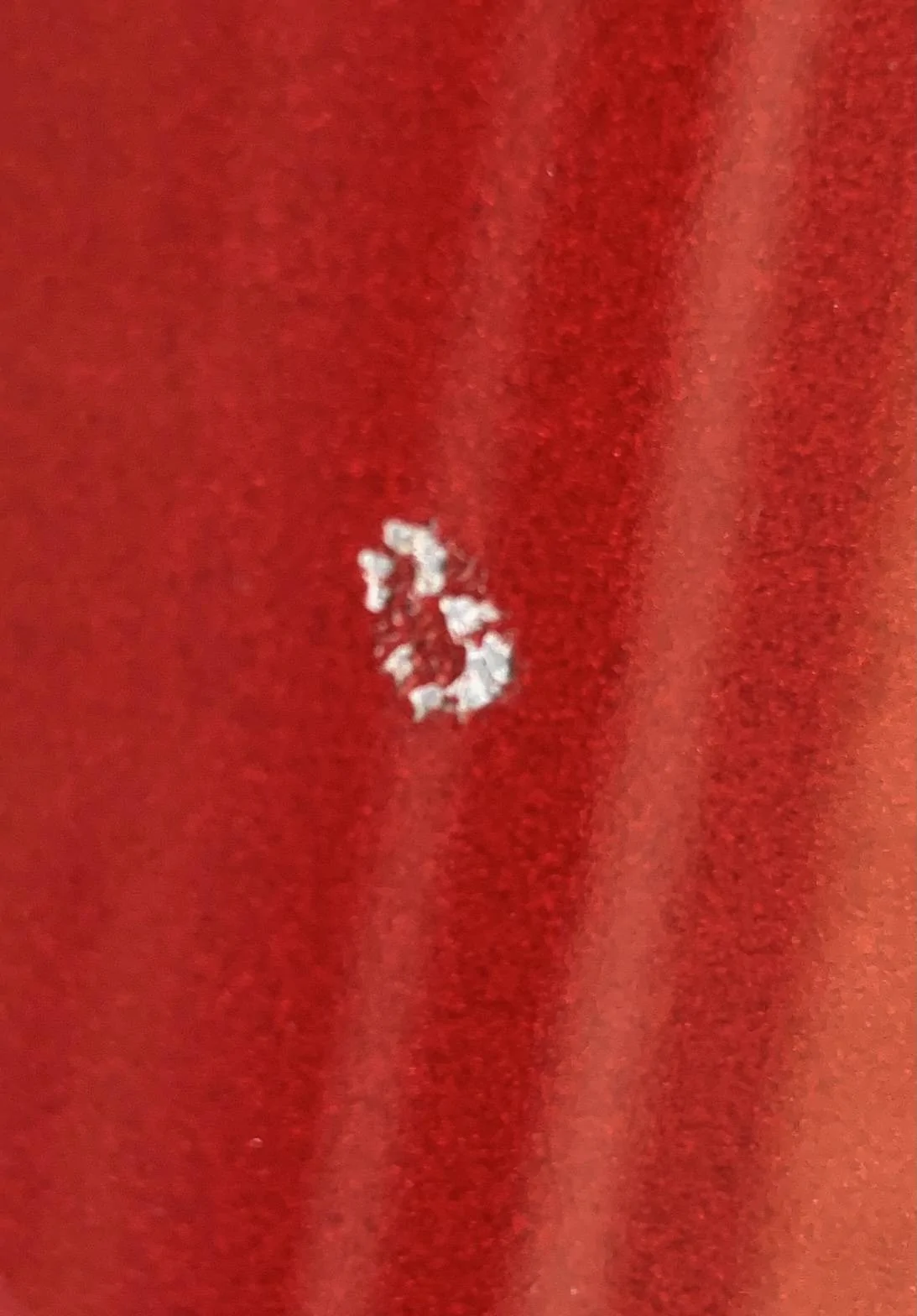

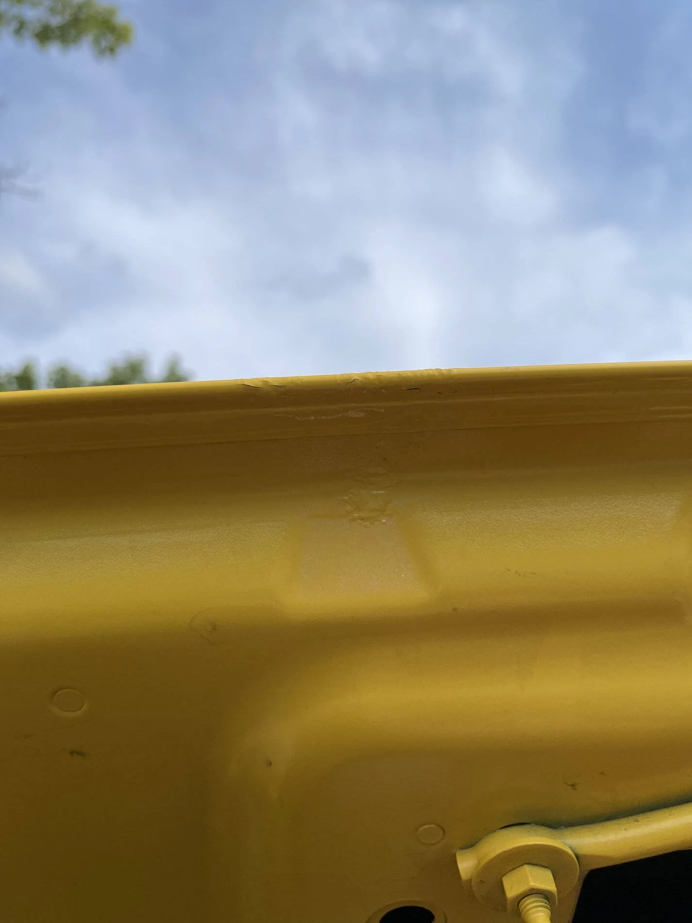

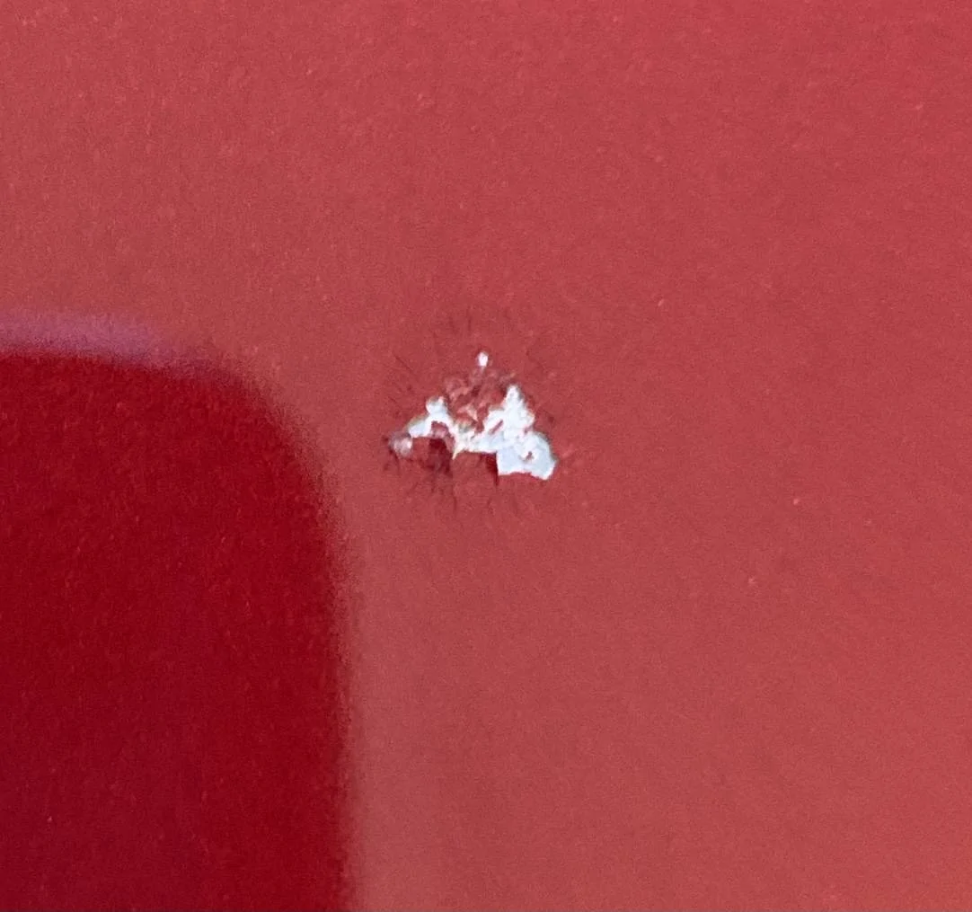

I knew the trunk was steel and would be the regular body warranty. It’s actually not as bad as the hood. The hood has some bubbling under the paint on top near the windshield. The trunk shows signs of starting to rust. First two images are the hood and the third is the trunk.

I did have a paint crack in the trunk, but the dealership turned down that request under the TSB; and started shying away from the perforation warranty.
But in all honesty, I'm not too worried about that, since I got rear ended last month and the body shop said they'll either replace or fix and repaint the whole trunk under the claim.
