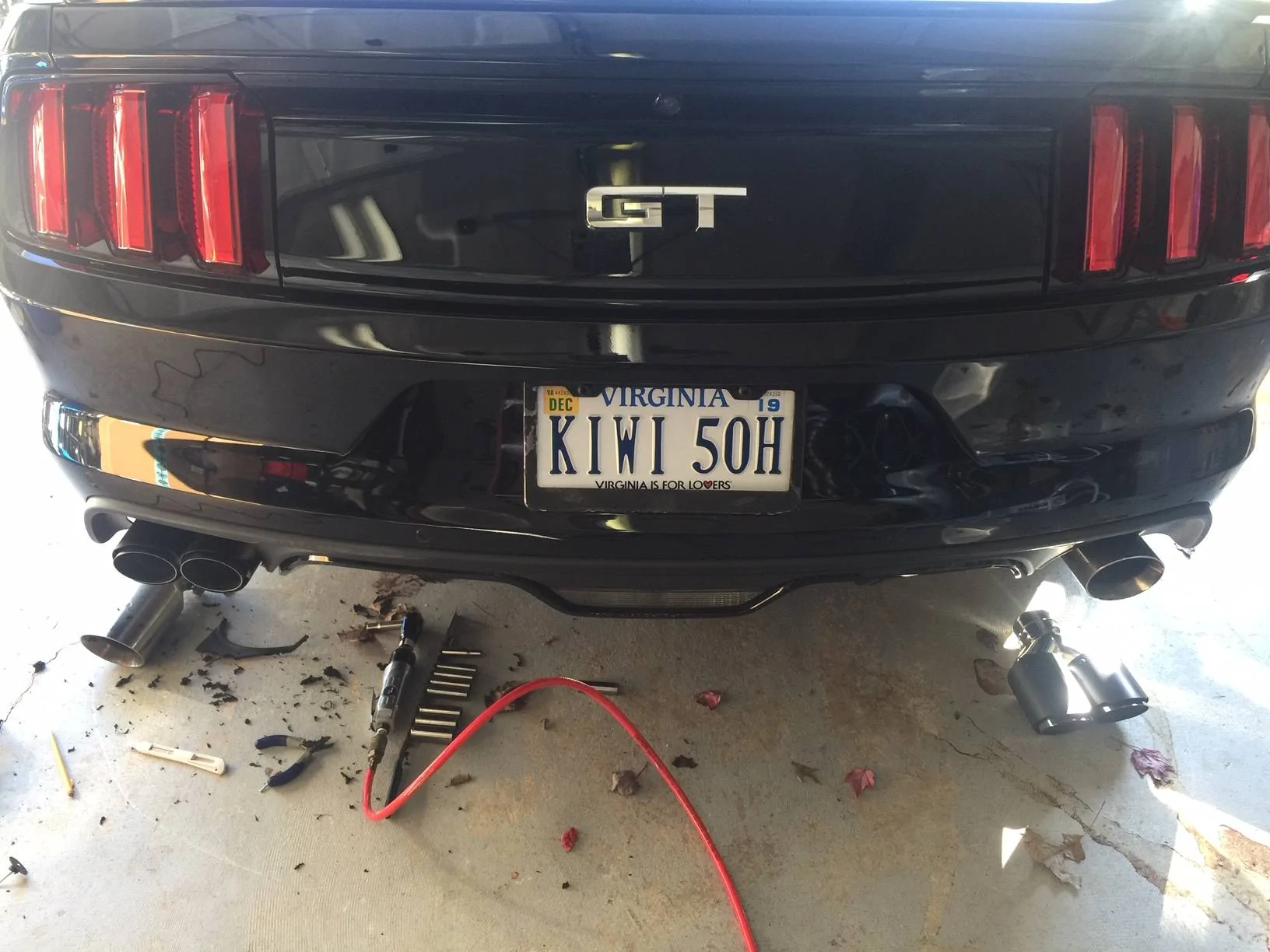

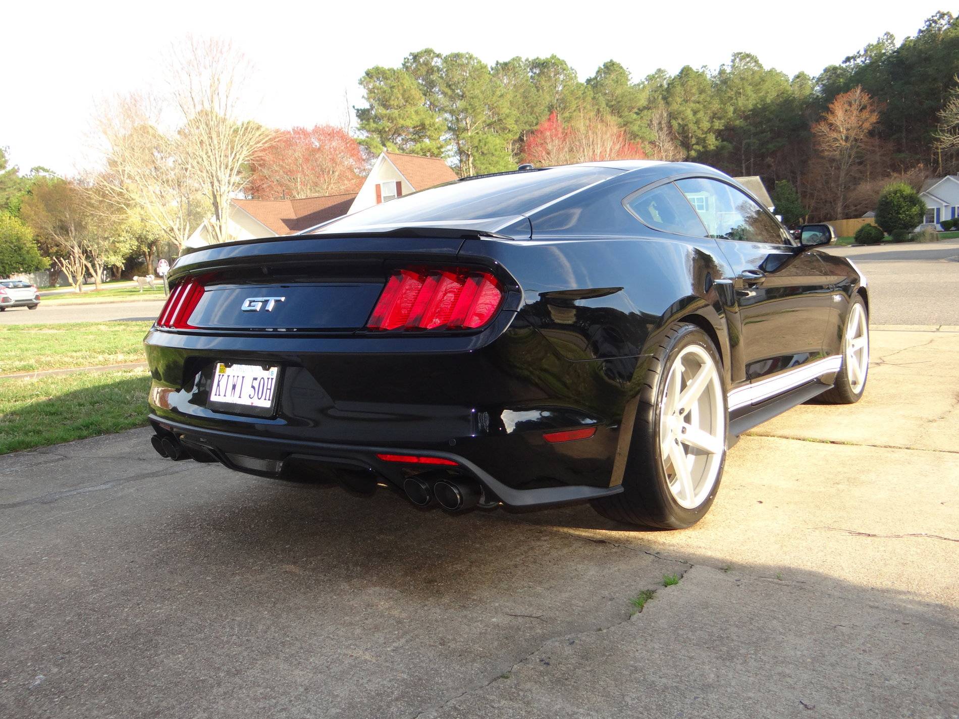

SLP makes the sames exhaust as the Roush axle back system but with more packing so its a little quieter. Its still a flow-through system so when you get on it the sound picks up. I combo'd that with the Magnaflow resonated X-Pipe for a little 'extra' but it is still very neighbor friendly. I have no concerns about noise on a cold start and really enjoy its tone when behind the wheel. Unlike the masses I really don't like the way the Coyote exhaust note sounds and I cringe when I hear a Corsa system so trying to keep it deep and mellow was my main goal. Since the Roush and SLP system use bolt on tips it gives you the ability to change things up if you want.
