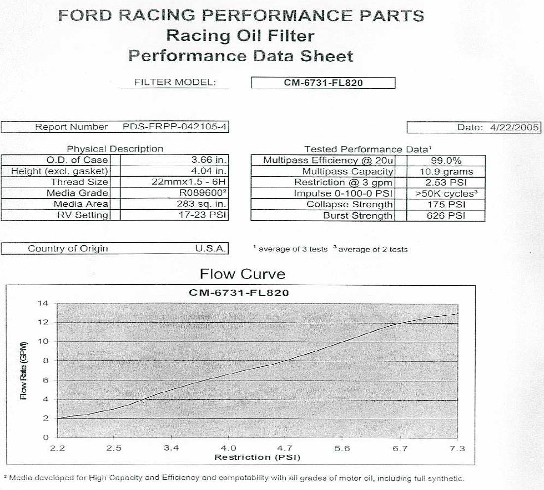

It has a higher psi before going into bypass. It flows more than the fram ultra xg2's. I've posted it's stats before. It's a revised fl820. The OE fl820 flows more than the fl500 Ford specs for it from the factory.

Here we are
the specs on both clearly show its not just an overpriced filter
Ford Racing CM-6731-FL820 Oil Filter

Lower bypass mean its stops filter oil sooner. The ford racing kicks its ass in flow even before going into bypass.
however the
oil viscosity during the Ford Racing filter delta-p test is missing, which is an important factor. Ive been given good reason to believe these amazing results were achieved with 5w50. However i regrettably cant say by whom. Youll be hard pressed to find a better filter.

Mustang guy, do you have the filtration data? I'd be more interested in the filter rating for particle size. I've seen similar in GT-R's problem is the filter usually goes up to 50-60 microns. But if it's filtering the same particles with a higher bypass valve setting, all the more for it.
