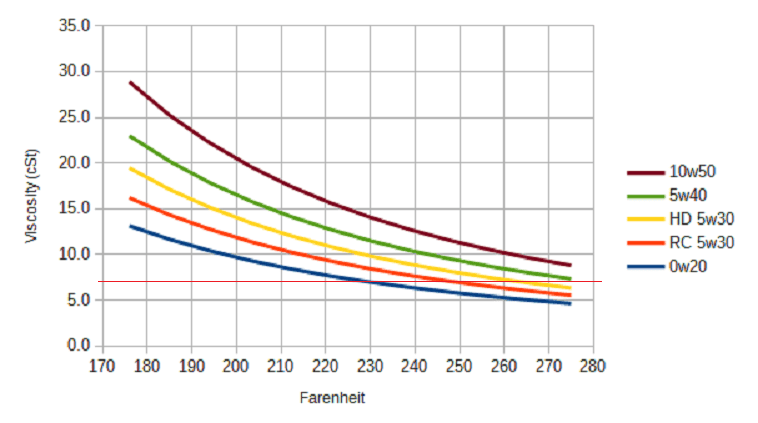

The listed oil viscosity for various bearing clearances are probably based on oil temperatures seen during normal street driving (ie, 200~210 deg F) since they don't mention anything about at what oil temperature those bearing clearances are based on. If they showed recommended oil viscosity vs bearing clearance for elevated oil temperature (ie, 250+ deg F) it would be a different story because of what I show below.
