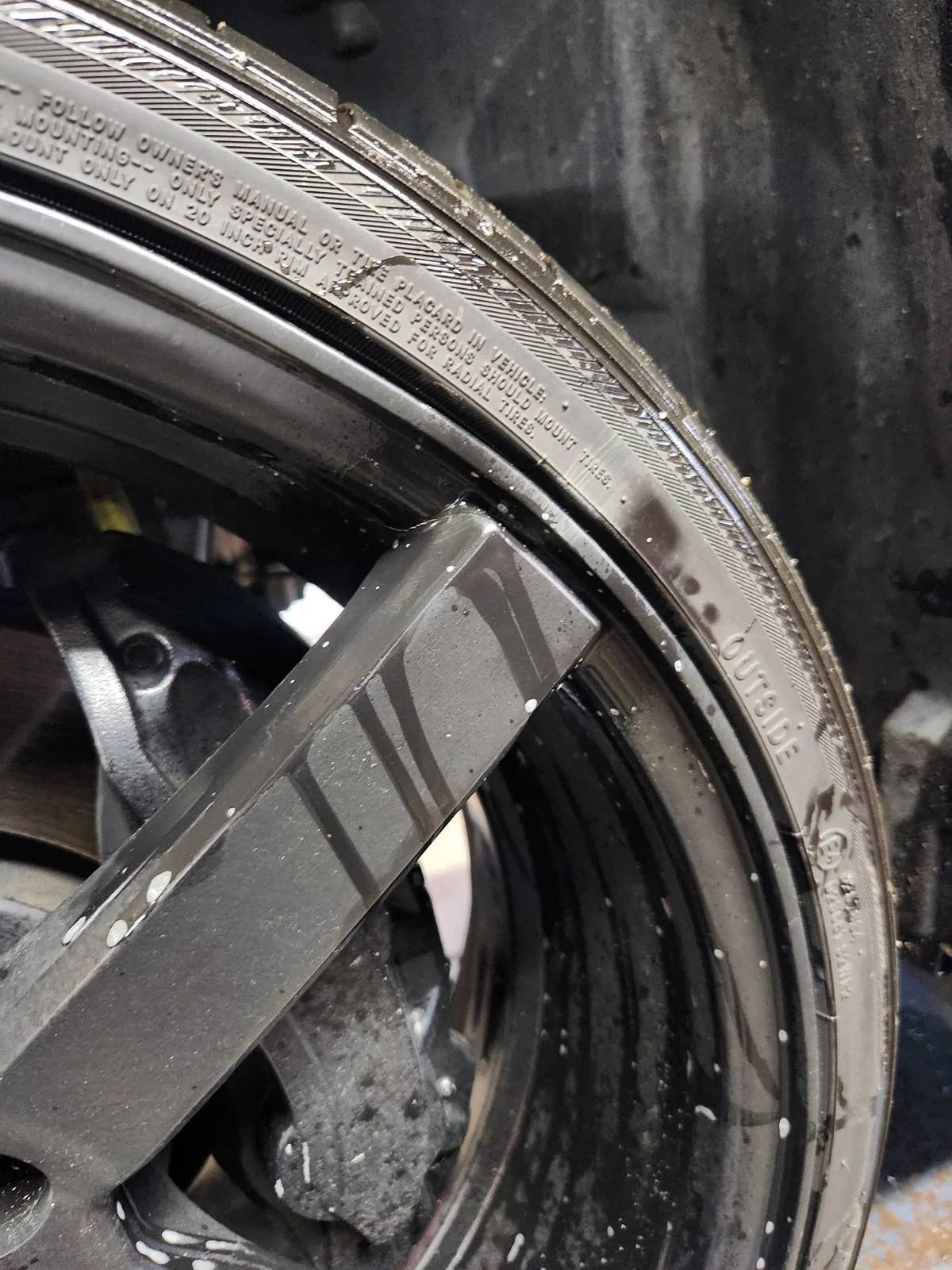

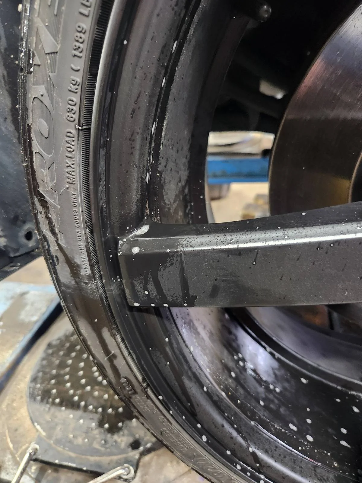

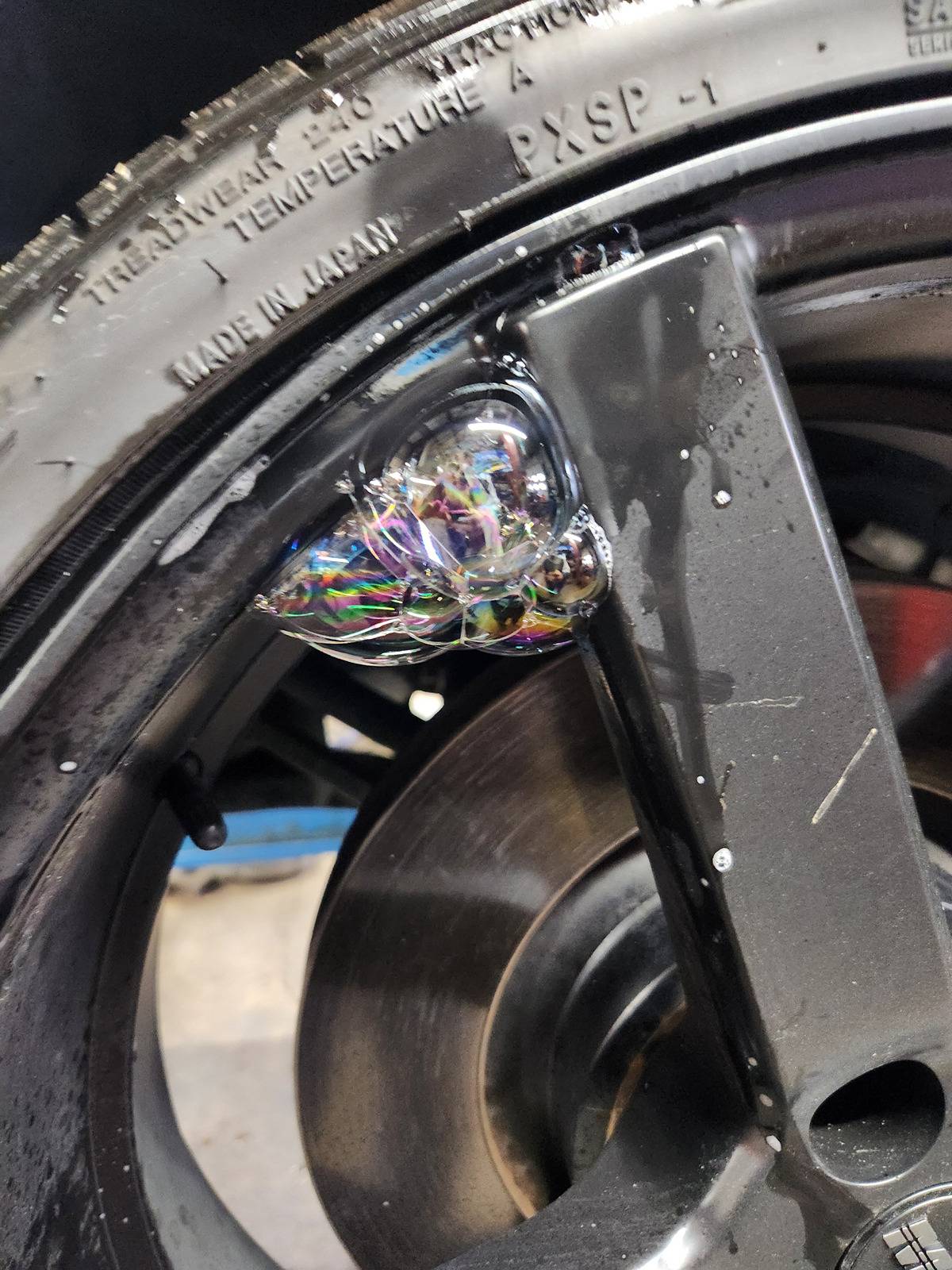

Whatever you do, don't buy their AM line of wheels in a 20 inch. I had their 551 C's on my car for less than a month. My drivers side started losing air so I took it to a buddy's shop and 4 of the 5 spokes on the drivers side and 3 on the passenger side had cracked where it meets the barrel of the wheel. The drivers side was leaking air, but the passenger side hadn't started to yet. AM was good about it and sent me labels to do a return and they refunded my money, but don't waste your money on their house brand wheels.
https://www.americanmuscle.com/mmd-matteblack-551c-20x85-2015.html
