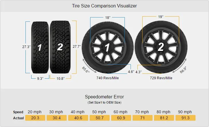

If I upgrade my 18' wheels/tires to 19' PP wheels/tires, will it throw off my speedo(due to the different tire heights) or will it be negligible?

Wheel size is irrelevant. Tire size is what's important with regards to your speedometer. Use a website like tirerack.com to find out the overall diameter of the tires you have and the tires you want. FYI, the OEM 18x8 wheels come with 235/50 Pirelli P-Zero Nero tires that are 27.2" in diameter and spin 765 revolutions per mile.

I don't have access to tire rack from work (blocked web site). If my 18" tires are 27.2, how many inches are the PP 19" tires?

[MENTION=12922]15GTBEN[/MENTION] I did just that, went from the crappy 18's to PP 19's. 275/40 all around, no issues with speedometer.
