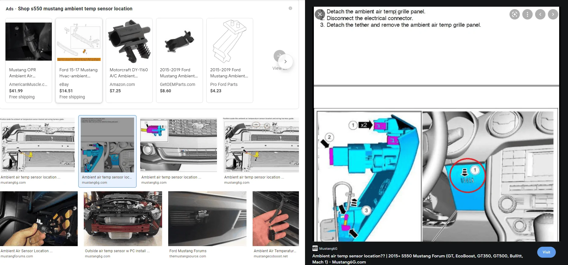

Hi, my media was damaged. The service replaced some module, which is located behind the display. Now everything works, but I noticed that the ambient temperature is still 3 ° C. True, it's winter, but don't change it. Where is the sensor to heat it with a hair dryer?

This might help, looks like it is in dash lefthand side of the multimedia display.

This, on the right picture is the sensor that measures the temperature in the cabin. On the left picture is the outdoor temperature sensor, right?
Yes correct
