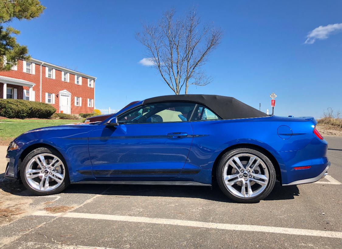

It’s funny looks like you almost have the same car as me but with the white stripe and fastback. The pony pack wheels look AMAZING against the lightning blue!
Actually, I just changed my avatar to show what I'm most likely to get - the black stripe. So it's closer to yours than you think!
You're right though - the wheels DO look pretty awesome next to that blue. Thanks for affirming my choice of combo! I'd been a little on the fence for a while, but I think I picked a winner here if how great yours looks is any indication.

I love it. As you can see the black stripe looks really subtle even in direct sunlight but I sort of prefer it that way
