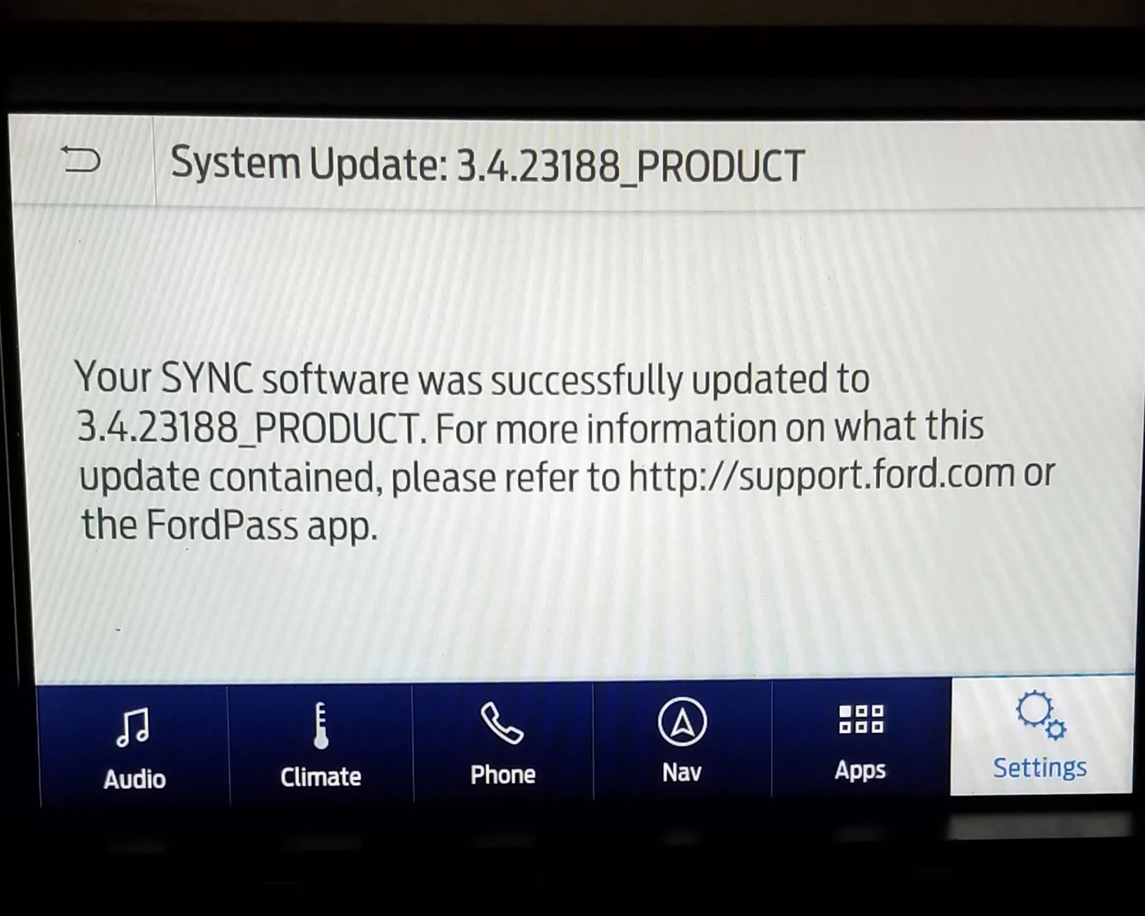

Yes, but what software version? You can see that on the settings screen, in the "about Sync" section. The latest version (and most probably the last ever) is 3.4.23188.
If yours is older than that, then maybe a software upgrade would fix it.

Yes, I have 3.4.23188. Maybe that's problem, lol. Maybe I should go back to the previous update. :crackup:
