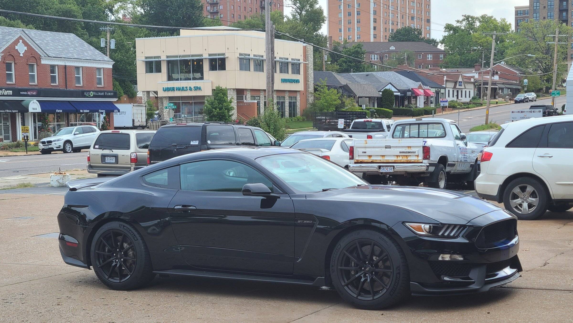

So you can run the 285/40/19s on the stock base Gt350 wheels? Im looking to run same tires but want to keep stock rims? no fitment issues?
Yeah, those are on the stock base GT350 wheels. no fitment issues, though I suppose the rears are a tiny bit stretched. its not noticeable at all though, and no issues with the tire/wheel fitment on the car mechanically.
Here's an old, shitty pic but I think it shows the fitment well
