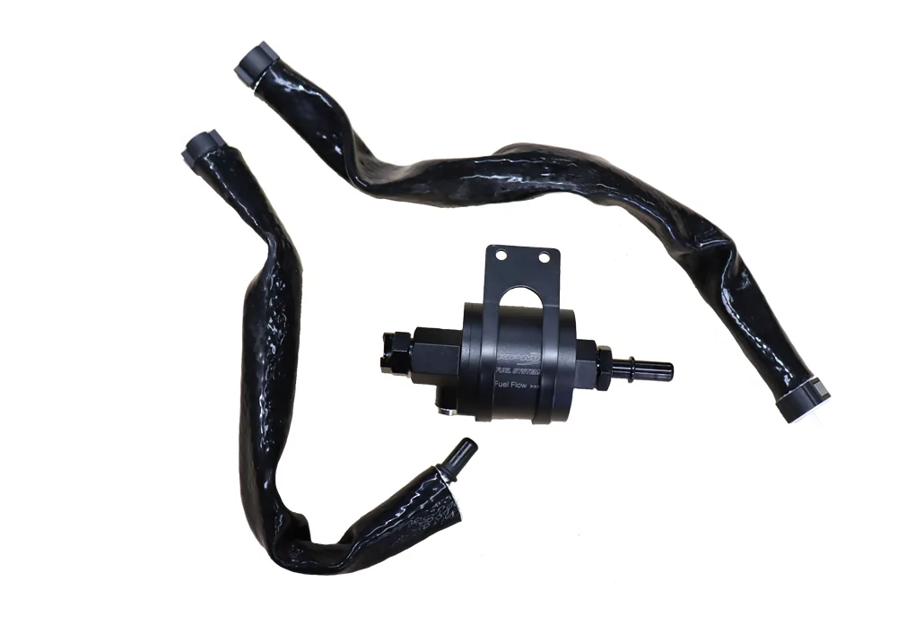

The wait is finally over!
KPM Fuel Systems has filtration covered!
Our E-Flex fuel filter kit to suit Mustang 2015 onwards features a large surface area 10 micron stainless steel cleanable filter.
Quick connect fuel hoses with heat shielding and mounting hardware.
Compact design for ease of fitment.
Compatible with all fuel types including gasoline, ethanol and methanol.
Filter body includes mounting boss for fuel pressure/temp sensor.
Filter body takes AN -8 fittings and can be outfit with various combinations if required.

Bravo, this might be even better than cobbling the the GT500 filter w/GM braided hose option. More details on the fuel lines inside those sleeves, please. (100% steel hard lines, braided stainless?) Thanks.

The fuel hoses are OE style formed nylon with quick connect fittings and we supply the heat shielding to go over them also.
I will have an installed photo on its way shortly.
These are to mount on the left hand side of the engine bay to the K frame by the stut tower.

Any safety/heat concerns with locating the filter housing in the engine compartment? What are the Ford Performance Racing School Dark Horses, equipped with the KPM800 system, using for their post-pump filtration?

I've watched prototype/development vehicles burn to the ground from failed fluid joints relying on O-Rings and Nylon hard lines (Corvettes are especially difficult to extinguish) and I'm apprehensive about adding more pressurized fuel line failure points inside the engine compartment. I'm still curious how the Track Attack Dark Horse cars address their fuel filtration with the KPM800 Pump. I'm not sure about the filter media and true micron rating on the GT500 filter media but, if it's fine with E85, KPM hasn't provided further details of how their Mustang kit has better quality and/or value over the GT500 filter w/GM braided stainless line approach. I'm still thinking of figuring a way to add the filter under the car, like the OEM GT350/GT500 filter, but the under-hood approach might be the most practical solution?
