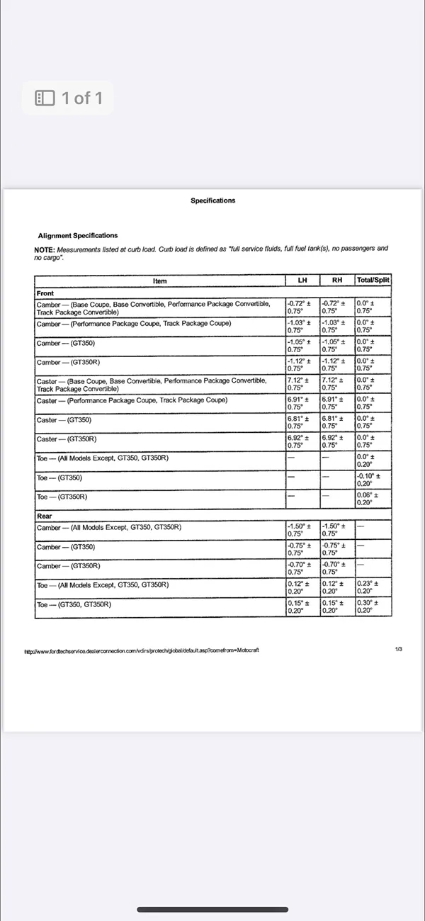

I have a 2018 PP1 that I recently installed steeds linear drag springs on. Car hasn’t had an alignment in 6 years at least so figured I should get it done.
I want to bring the info the to shop as I am not confident they will have the specific specs for a PP1.
this sheet may also be helpful for others.
