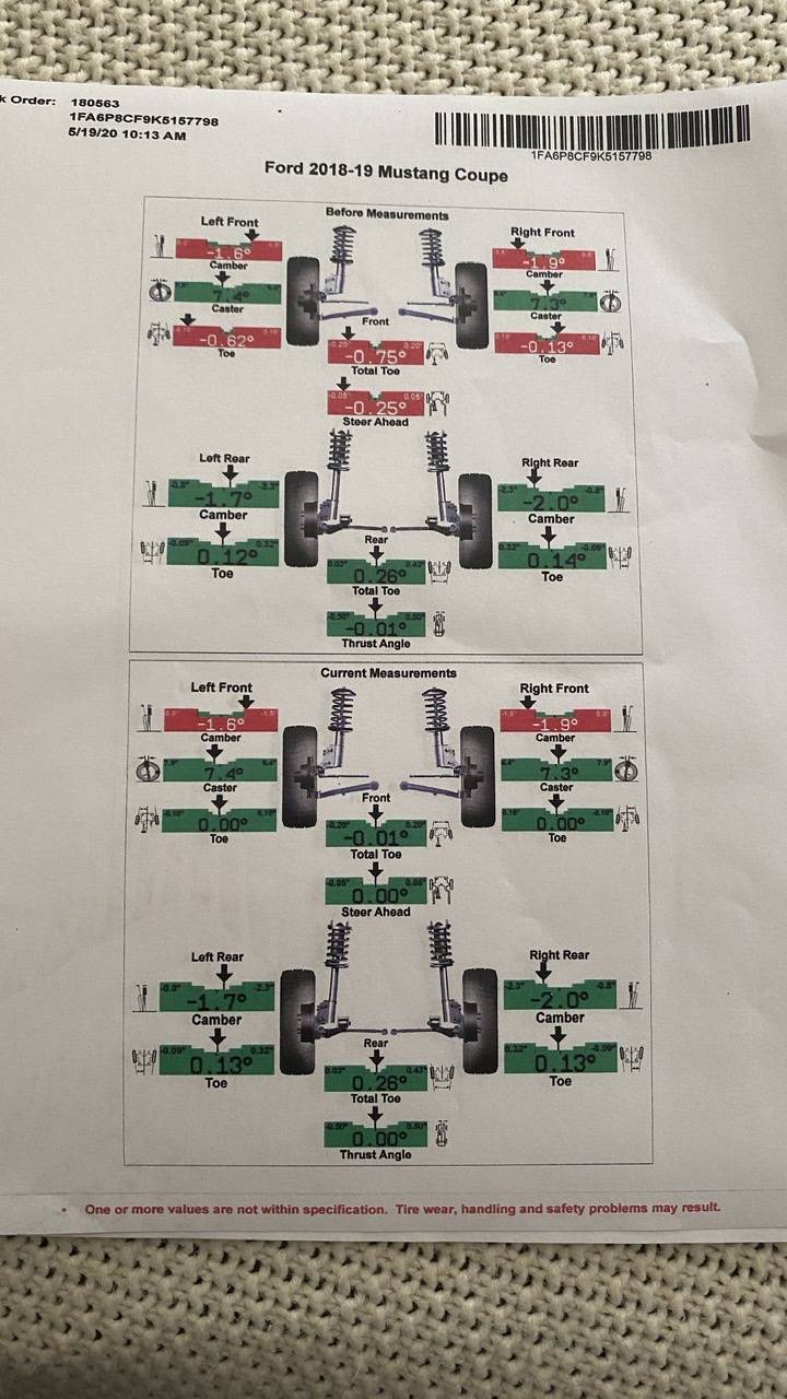

I did the BMR SP763 min drop kit and went to get my alignment before putting my new wheels and tires on.
I was looking and it doesn’t appear they touched the camber.
I bought some camber bolts from BMR but I haven’t installed them yet.
What do you guys think?
Front dropped about 1 inch and rear was .5inch

Front camber isn't adjustable without camber plates or bolts. They could at least get the rear camber even on both sides, but doesn't look like they bothered to try.
