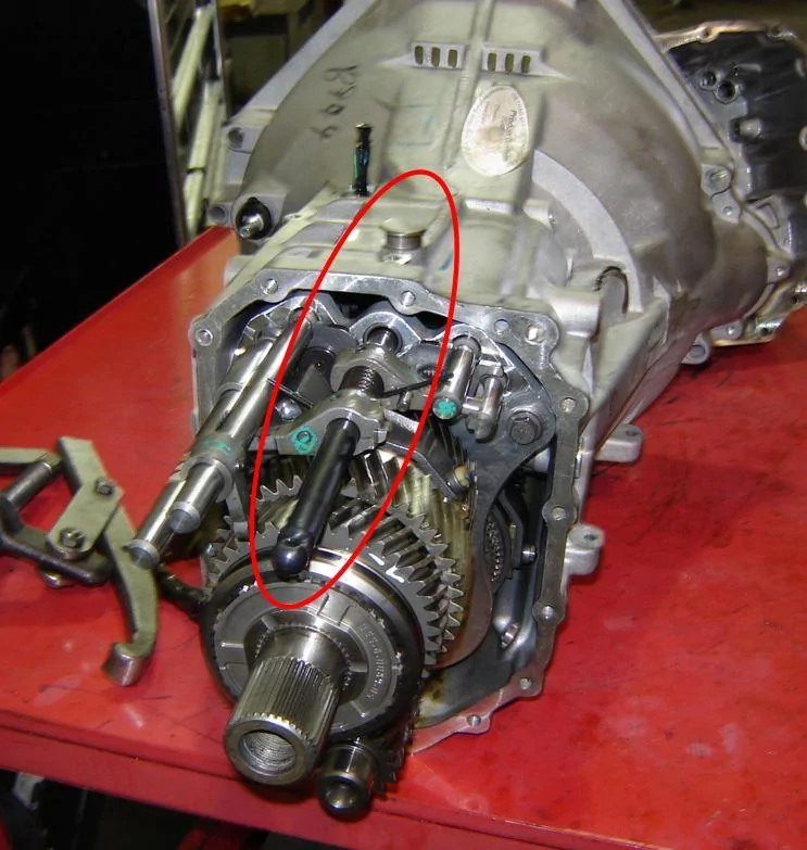

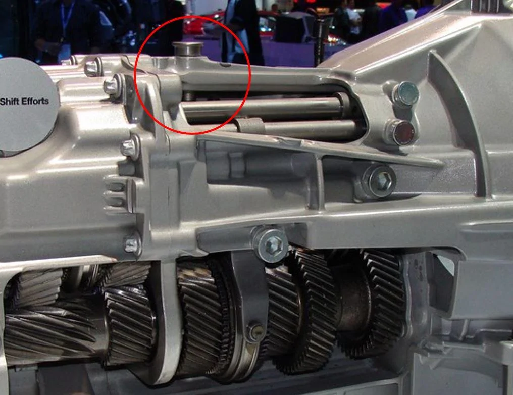

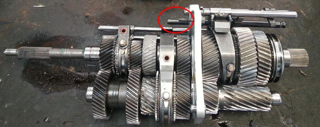

The MT82 has internal stops. At least the pre-2018 ones do. I’ve not touched/seen the MT82D4 internals.Now that you mention it, do aftermarket shifters have "positive stops" in them to protect the forks from damage? I have been running a Barton shifter for about 50K miles and have never had any issues bangin gears at 7.5K RPM's. During install I found it strange I never noticed any "stops" built in like they had in the fox bodies with the T-5 transmission. How many of you guys out there have an early 2018 GT with an aftermarket shifter and currently have not broken a shift fork?
Are they adjustable?The MT82 has internal stops.
With a welder and grinder?Are they adjustable?
Um... where did 3rd gear go?
