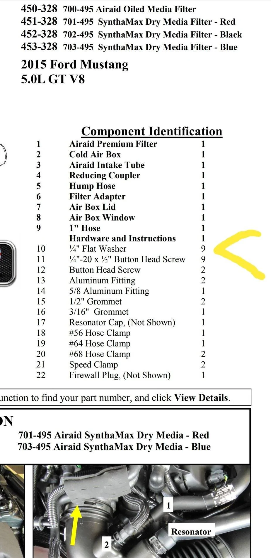

Probably a tough one to answer. Ill probably just have to measure and hope i get it right the 1st time lol. Does anyone know the size of the Allen head screws that hold the clear plastic cover in place?

When google is your friend: 5/32.

The bolts for the plexi cover are 1/4"-20 x 1/2" long.
