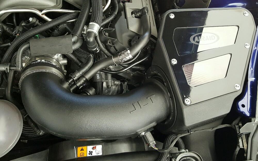

Hey Gibb, check out what Sick03L did, lol!! Interesting and pretty innovative. Have the best of both worlds!!
That is pretty interesting :thumbsup:. Certainly is the best of both worlds.
