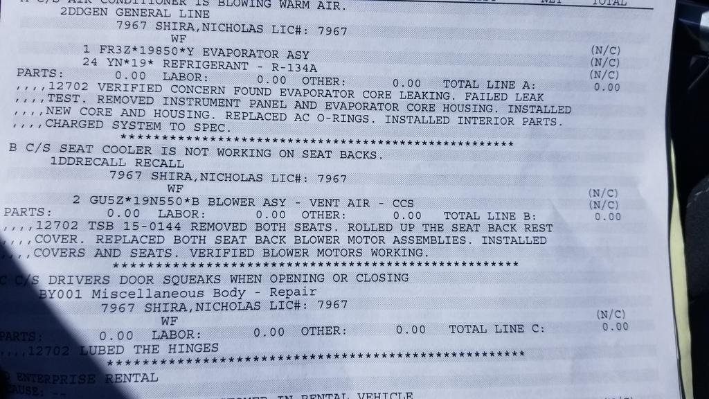

Well, my car is back and AC is working, but all they did was recharge it. I can't imagine a car losing refrigerant in 1 year/7K miles without a leak.
I'm assuming it will eventually fail again and they can actually fix it then...
Well, that didn't take long...
AC went out again on the 25th. Fortunately, SoCal was in the midst of a record breaking heat wave so it was really easy to tell in 100 degree weather. I didn't notice in the morning on the way to work - thank God I have a short commute cause it was painfully evident on the way back home. :headbonk:

yup evap core, dealer had my gt for a week

My A/C was perfectly fine for about 8000 miles and suddenly one day I see green stuff all over and when I mean all over, I mean literally all over my garage floor. Obviously A/C is blowing hot air. Car went in and was out in 2 days, new compressor and new A/C lines. It has been 7000 miles since then and no issues.
