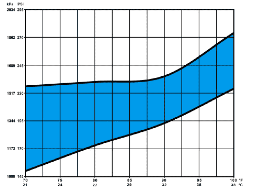

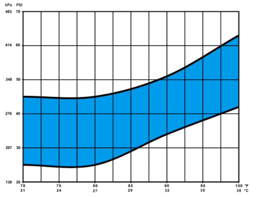

I would first check your refrigerant pressures. Ford has a really nice set of temperature dependent suction and discharge pressures in chart form.
Discharge Side:
Suction Side:
My A/C was doing what you are describing last year and I tested the pressures according to the workshop manual. Turned out the refrigerant was just a little low, such that when you increased engine RPM and airflow across the condenser, it would cool as it should, but at low engine and vehicle speed, it wouldn't.
I never figured out where the refrigerant "leaked", but adding a bit until the suction and discharge pressures were in the right spot has kept it operating correctly for over a year. Note that Ford also puts in dye at the factory, so a large leak should be apparent using a UV light and glasses. I couldn't find mine.
