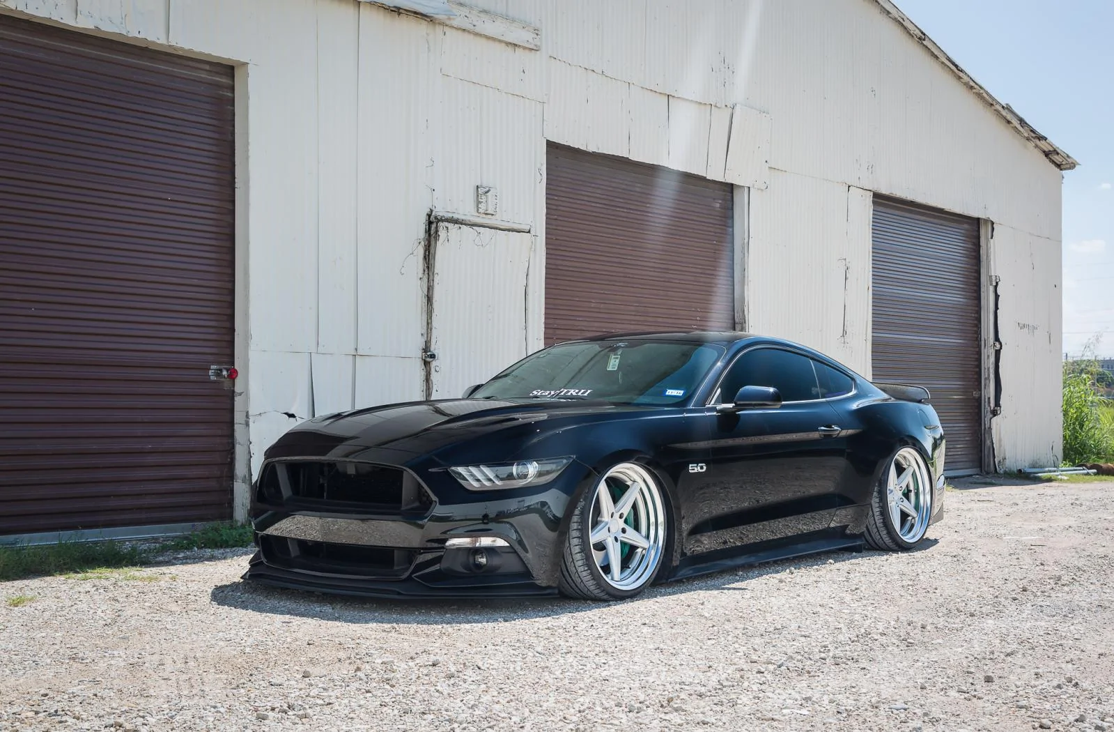

Aren't these the ones mike@vossen had? Wheels used to be silver? What are the specs on the rear? Weren't his like 20x12 +50?
Different wheels same type. Both are the VWS3. I custom ordered mine they are +45 out back, they're slightly different then those. Mine don't sit as far in on the lip but are super concave where those are pretty flat.
Your rears are 20x12 +45?
