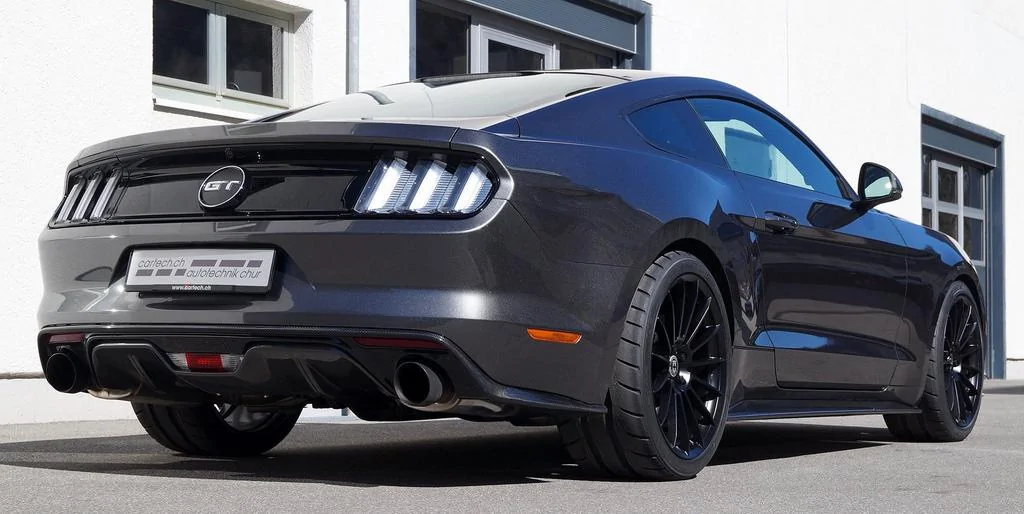

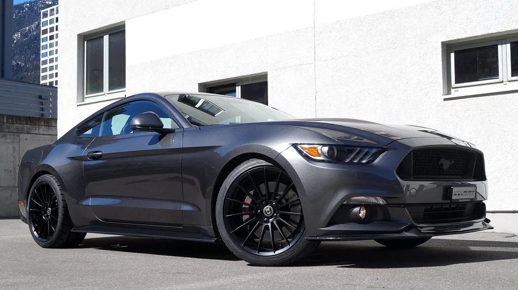

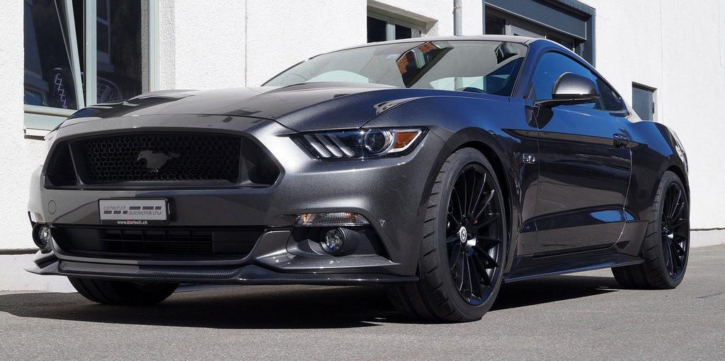

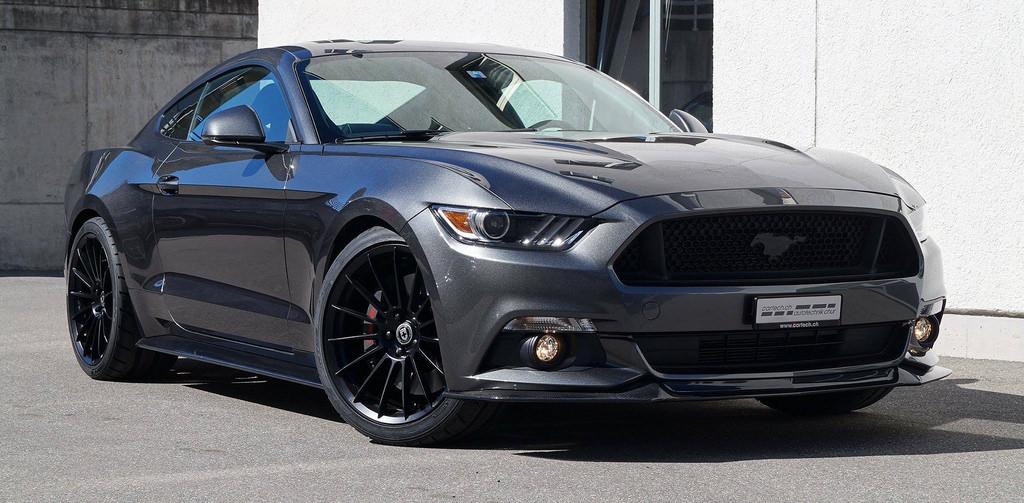

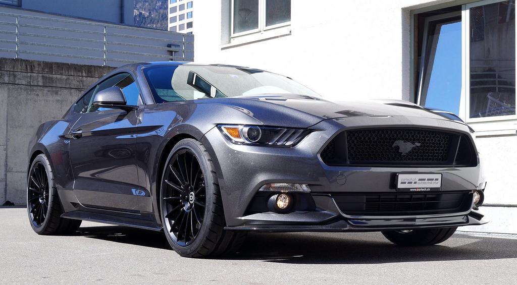

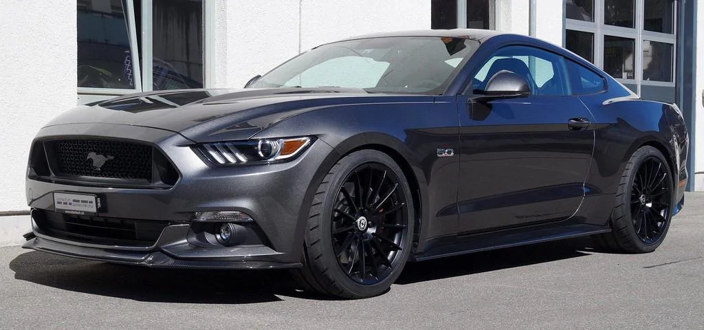

S550 Mustang GT with FlowForm FF15 Wheels in Tarmac!
20x10 / 20x11 fitment :)
What are tire sizes buddy?
You might not know this but what are the front license plate dimensions, seems a nice and subtle size for a front plate. :)
