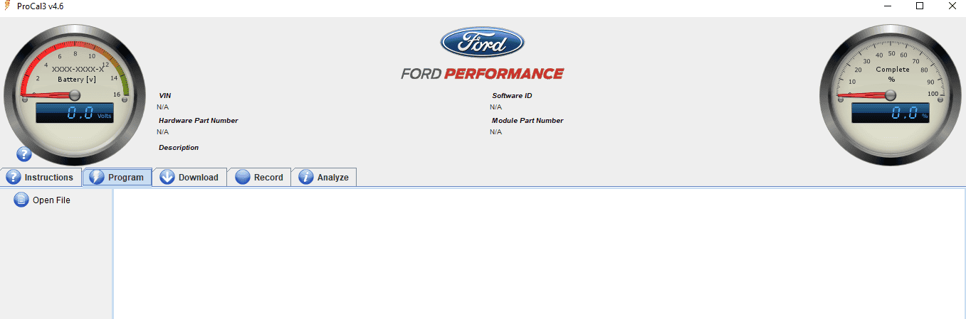

Ok glad I decided to try tune first. Procal3v4.6 showing in top corner.
The only tabs it shows are;
Instructions - Program- Download-Record- Analyze.
There is no diagnostics tab or configuration tab.

I axed the install until I figure out why my menu tabs on my procal3 file don't match the instruction menu tabs they have listed. It pulls the battery info and vin and what not but the tabs aren't matching.
Not sure If I got the wrong procal3 version or what. Ill call Monday.

The instructions I printed out a long time ago match the instructions word for word off the instructions tab i clicked today on procal menu.
There is no diagnostics or configuration tab. This prevents me from doing any DCT checks or profile learn or octane adjust which appears I might need if there is pinging like you mentioned.
It also prevents me from doing a crank relearn which is common after install.

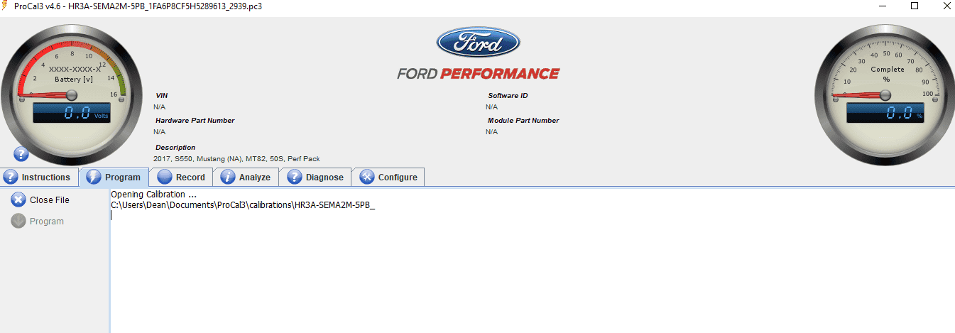

Those tabs won't show until the tune is downloaded from frpp.
Log in through procal and then once it downloads the tune from frpp different tabs populate. Only when the tune file is selected will additional tabs populate. Once you close out the tune file it goes back to the reduced tab you are currently looking at
The octane adjust wont become available until after the tune is loaded either. It doesn't reflash the tune, only changes some setting somewhere.

Ok, I see where it asks for the email, voucher # etc to download calibration. I got nervous because that was the next page on the instructions with the previous page showing those four tabs I didnt have. I was unsure whether to move forward with that next process.
This is my first tune install ever and quite frankly not well versed on computers.
